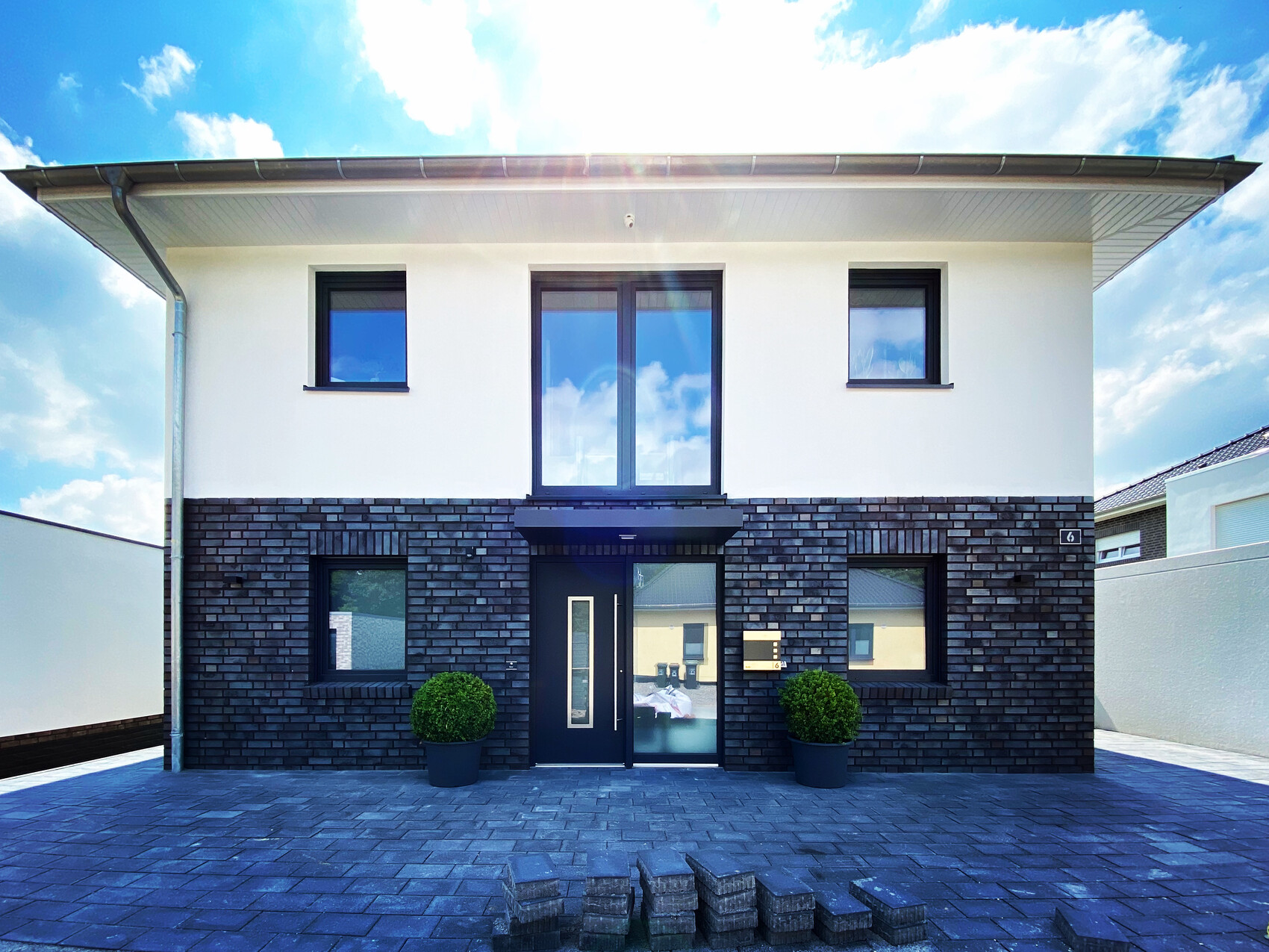

Golfi908 Aug 2020 17:19
Take a look at the canopies from Gutta. They are made of aluminum composite material. Extremely lightweight (canopy weighs 35kg with 2m (6.5 ft) width) and easy to install. There is also a matching side panel available!

hegi___
9 Aug 2020 12:02
Golfi90 schrieb:
Take a look at the canopies from Gutta. They are made of aluminum composite material. Extremely lightweight (canopy 35kg with 2m width) and easy to install. A matching side panel is also available!
I think this is how we will do it. That’s a good idea.

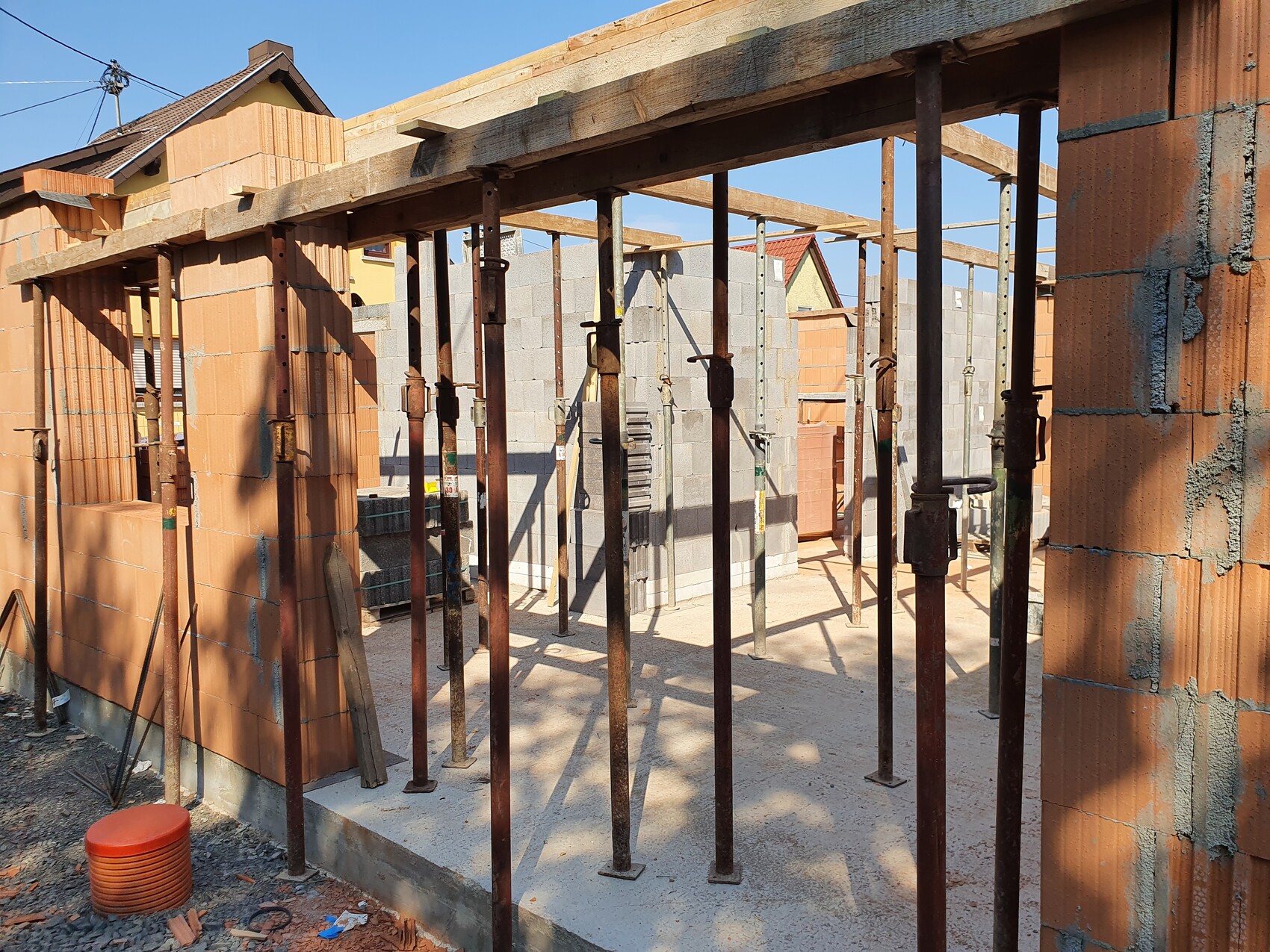

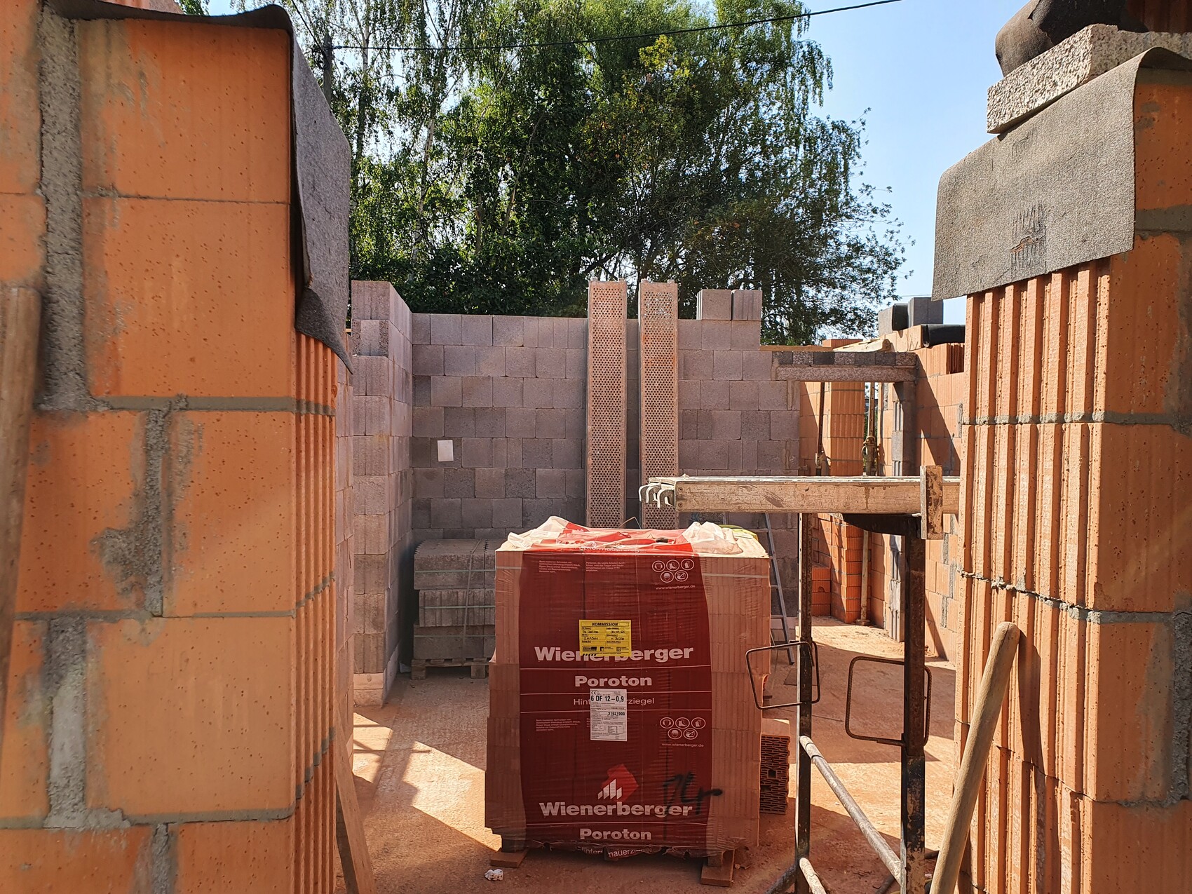

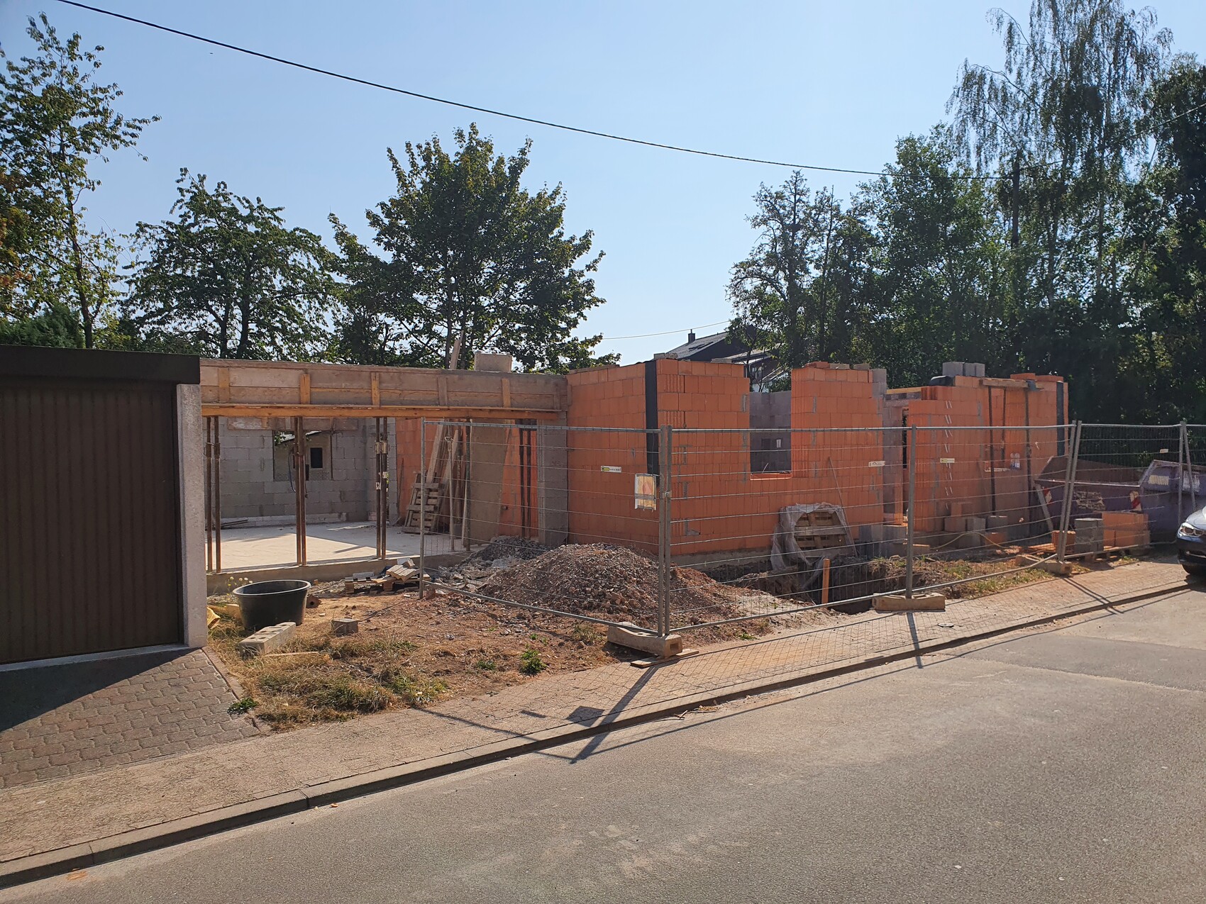

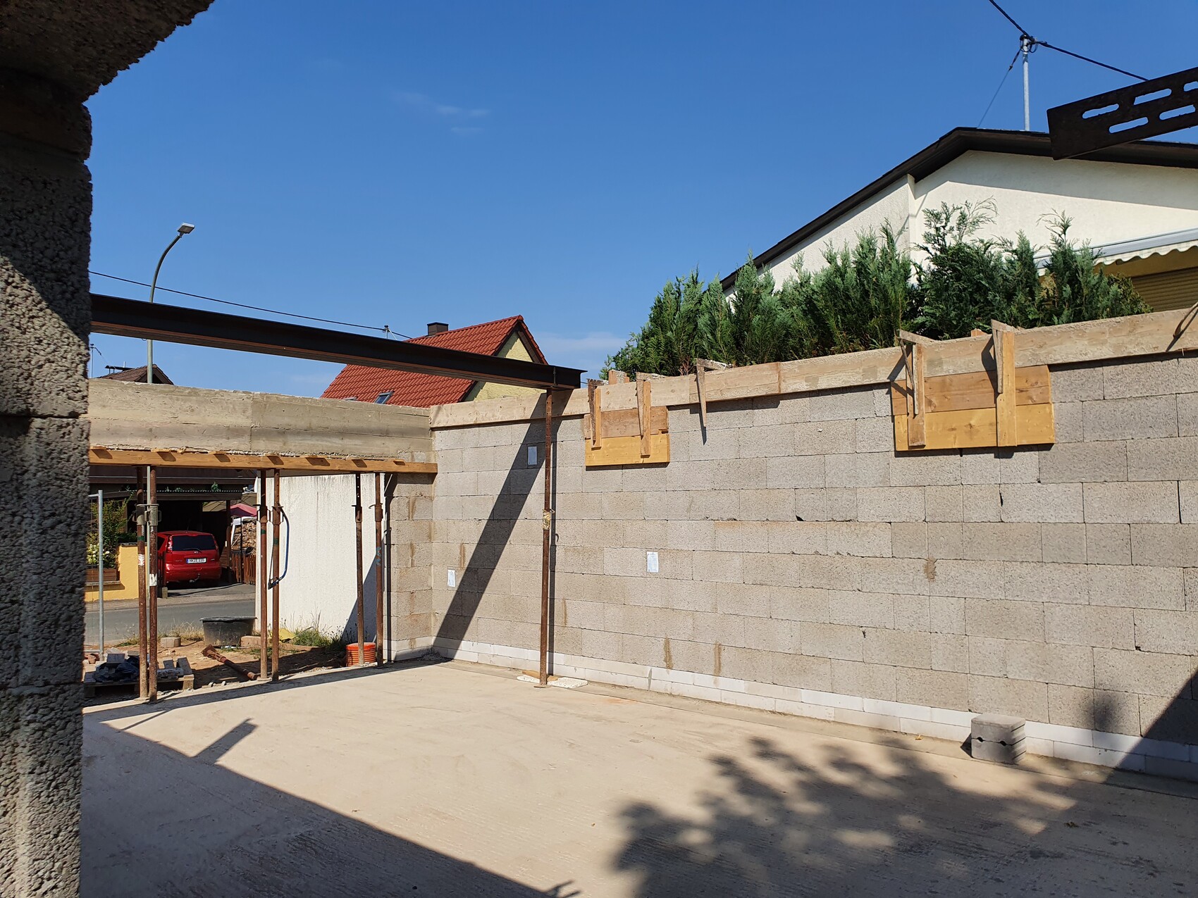

The ceiling is finally scheduled to be installed on Thursday. Steel beams for the garage have already been delivered and still need to be positioned.

Golfi9010 Aug 2020 07:14
If you contact the seller "Sixone" on Amazon, who offers the canopies, you can even order custom-made ones. For example, a roof with a width of 2.50 m (8 ft 2 in). The additional cost is relatively low and very reasonable!
You can also order a built-in mailbox in the side panel, and more.
We are very, very satisfied!
