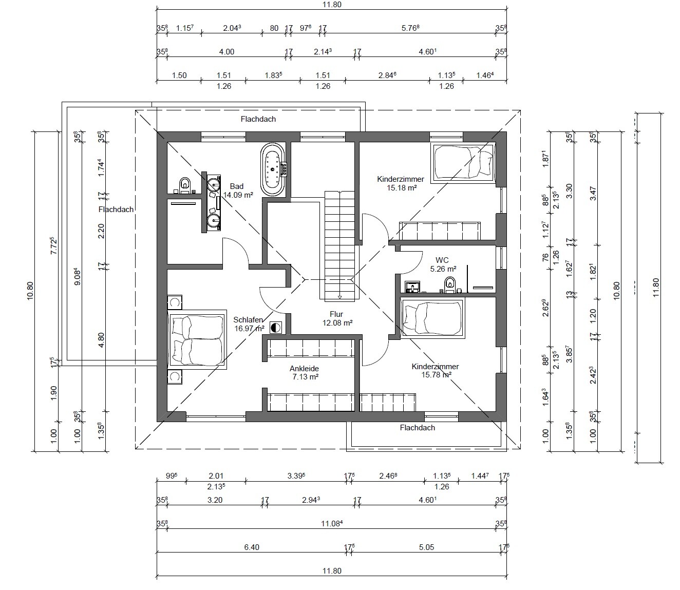

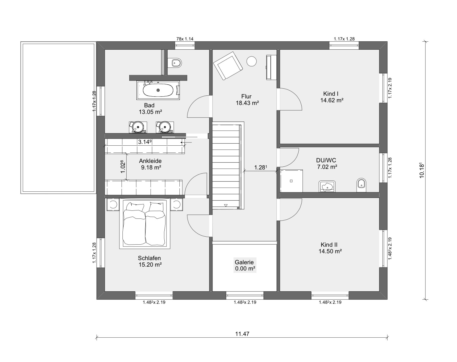

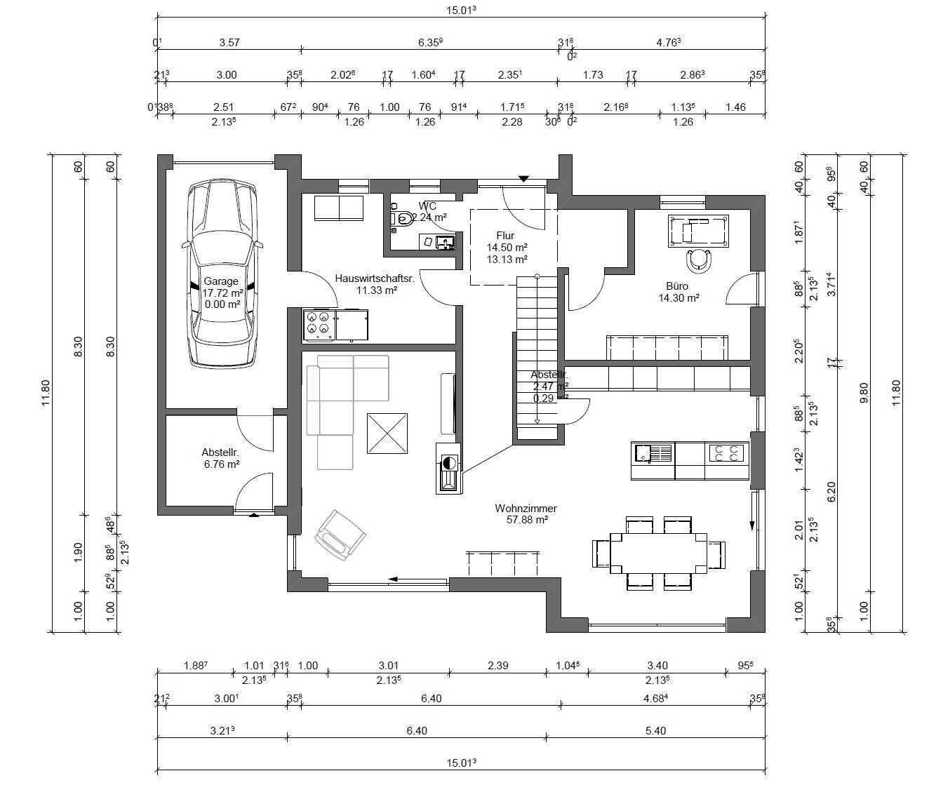

Here is an example offer from one provider (please do not discuss the floor plan and exterior view further; this is the provider’s first draft):
– Urban villa on a slab foundation, 2 full stories, 25-degree (25°) hip roof, 184.5 sqm (1,985 sq ft) living area, KfW 55 standard
– Flue for fireplace
– Plastic windows on the ground floor (except entrance side) with external venetian blinds, other windows with electric aluminum roller shutters
– 2 lift-and-slide doors in the living/dining/kitchen area, one 241 cm (95 inches), one 195 cm (77 inches) wide
– Granite exterior window sills and artificial stone interior window sills on all windows
– Straight closed oak solid wood staircase
– Concealed rain shower in the master bathroom
– Air-to-water heat pump (A2/W35) with DHW storage tank SH 290 RW (277 liters (73 gallons)) and buffer tank (120 liters (32 gallons)) with underfloor heating in all rooms (with cooling function)
– Ventilation system with heat recovery and cooling function
– Plasterwork to Q2 level (for textured wallpaper)
– Wall and floor tiles in wet rooms (33 sqm (355 sq ft))
Offer price: 419,500 EUR or 2,274 EUR/sqm (211 USD/sq ft approximately)
Additionally, the following owner and subcontracted services apply:
– Garage 20,000 EUR
– Flooring (labor and materials): 27,000 EUR
– Painting work (labor and materials): 15,000 EUR
– Panoramic fireplace including installation: 7,000 EUR
– 7 kWp photovoltaic system including installation: 8,500 EUR
– Buffer for final selections: 10,000 EUR
Total: 507,000 EUR or 2,748 EUR/sqm (255 USD/sq ft approximately)
What do you think?
