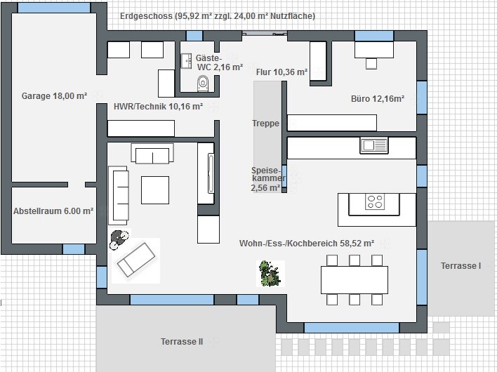

DaSch17 schrieb:

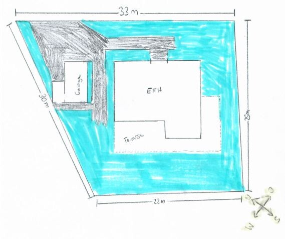

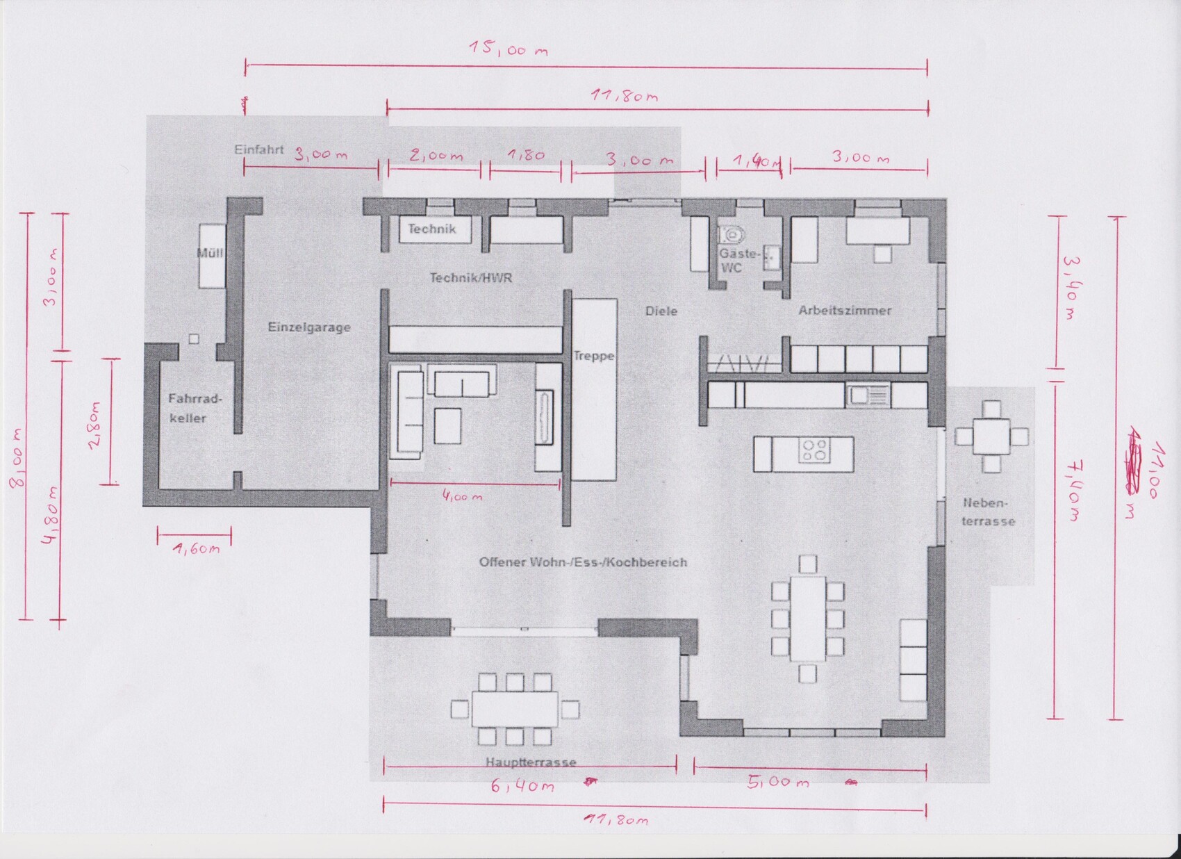

Attached is the revised ground floor plan.Not just revised, but ready for vacation, I would say: The second car is parked only on the driver's side up to about the windshield under the carport corner of the garage building? ? ?https://www.instagram.com/11antgmxde/
Not just worn out, but ready for a holiday, I would say: the second car is parked only with the driver's side under the carport corner of the garage building, up to about the windshield ? ? ?I think it's quite good. The furniture in the living room seems a bit small to me. The entrance area feels too tight. The upper floor should work.
The garage concept seems nonsense to me. I see no reason not to attach it to the house and make it bigger. The passage is pointless and only creates a wind tunnel effect.

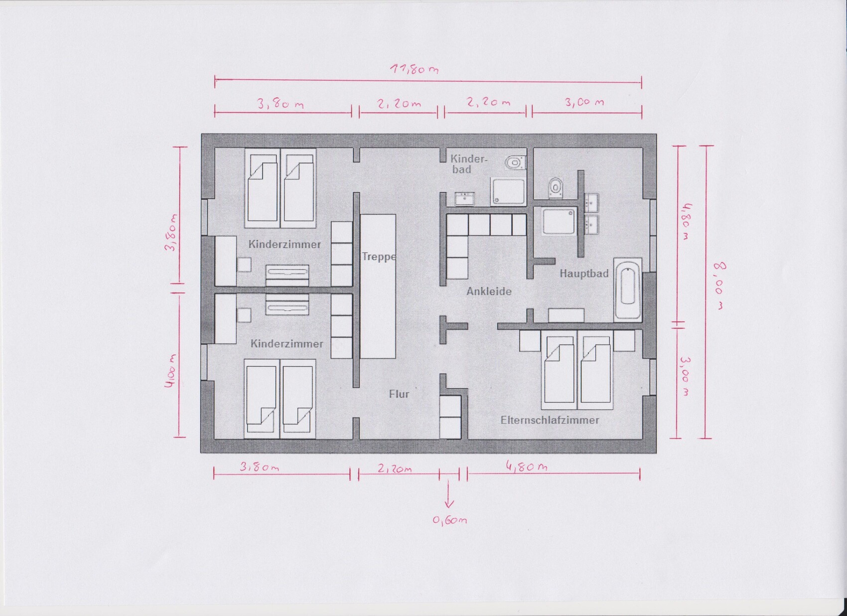

We have meanwhile moved away from a knee wall height of 215 cm (85 inches) and two full floors, mainly for aesthetic reasons (we think this just does not create a nice exterior appearance). Instead, we are currently leaning more towards a knee wall height of 140-160 cm (55-63 inches) and 1.5 floors, which should also significantly reduce the construction costs. The pitch of the gable roof will likely increase accordingly, which will provide us with valuable storage space in the attic.
A solar photovoltaic system has been added to our list of special equipment requests.
Your many good ideas have motivated us to revise the floor plan design once again.

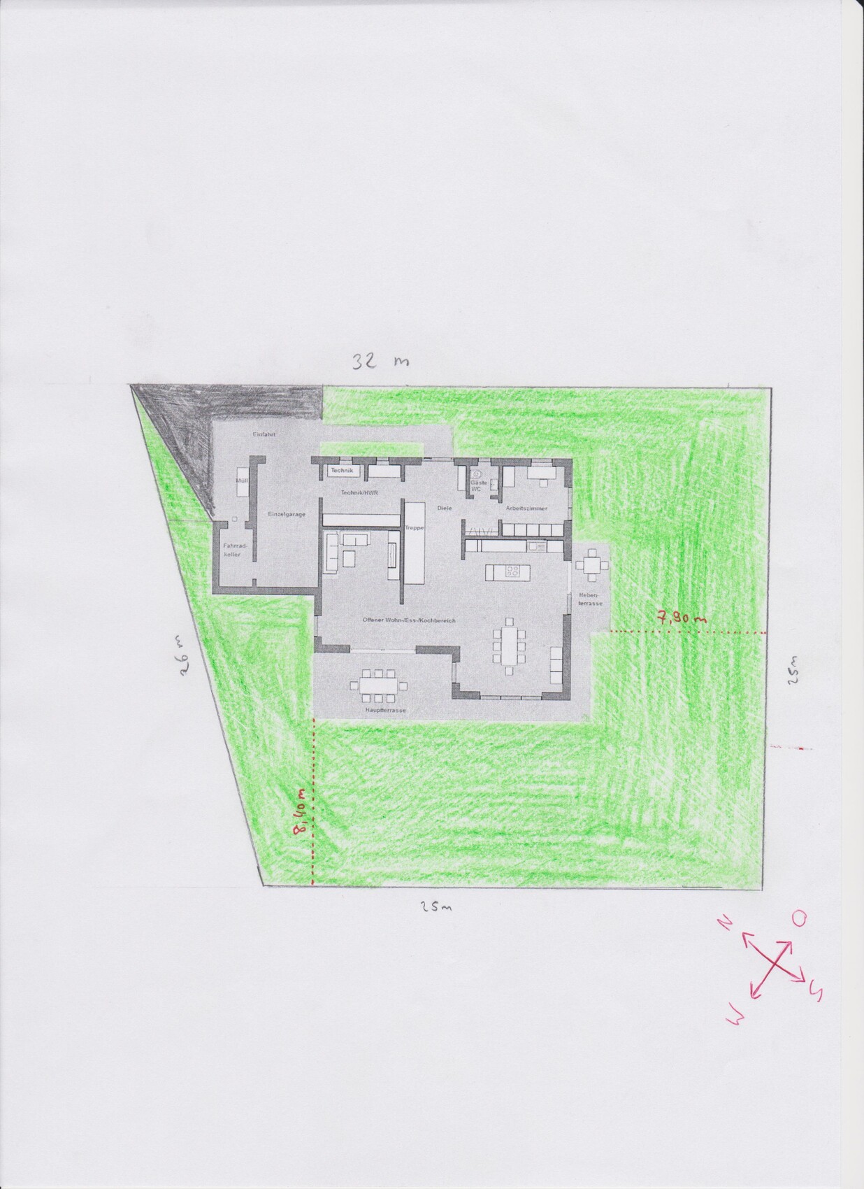

For better understanding, here is the planned location of the single-family house on the plot:

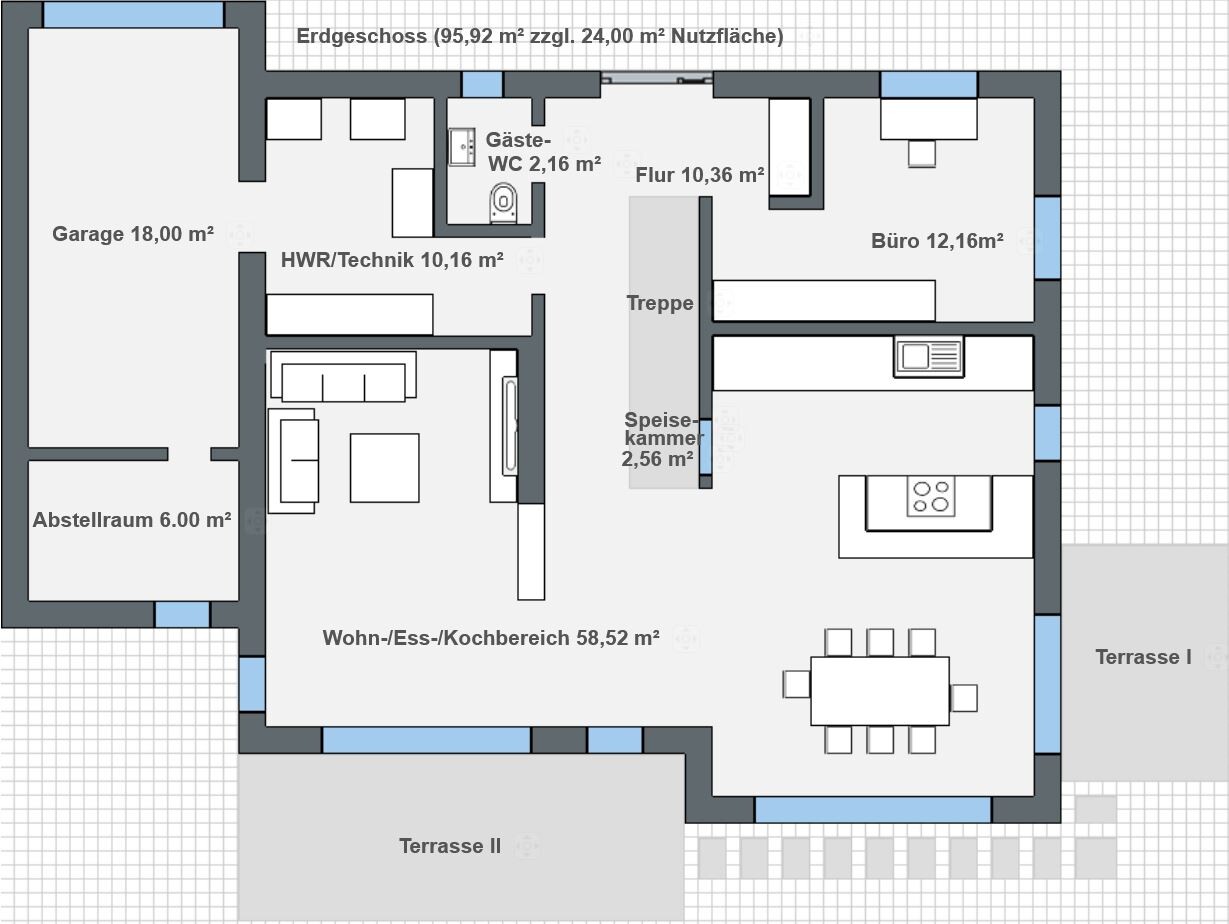

Ground floor plan:
First floor plan:
What we don’t like about the first floor plan is that the children’s rooms are not facing the garden side and the children also look out of their (floor-to-ceiling) windows onto the garage. Due to the location of the staircase, unfortunately, it is not possible otherwise—unless anyone of you has an idea?
The long sides serving as roof sides have no windows. We would like to equip every room on those sides with a roof window. There are also current considerations (mainly for aesthetic reasons) to install a dormer on each roof side at the height of the hallway.
Thank you in advance for your suggestions, praise, and criticism!
I find the layout on the plot much better now.
Green the garage for the children?!
Mirror the upper floor including the staircase?!
Dormers from an aesthetic point of view on the outside – that’s possible, but in the hallway, given the costs, you won’t gain any meaningful additional space. That would be much more relevant for the children’s rooms or bathrooms. Also, take a look at this with a knee wall height of 140–160cm (55–63 inches). Maybe a cross gable would be a better option?
Roof windows in bedrooms or children’s rooms provide wonderful natural light (if sized appropriately), but also come with a certain level of noise.

DaSch17 schrieb:
In the meantime, we have used the time to optimize the floor plan a bit more.
I'm curious to hear your thoughts on the following ground floor plan including a single garage...
