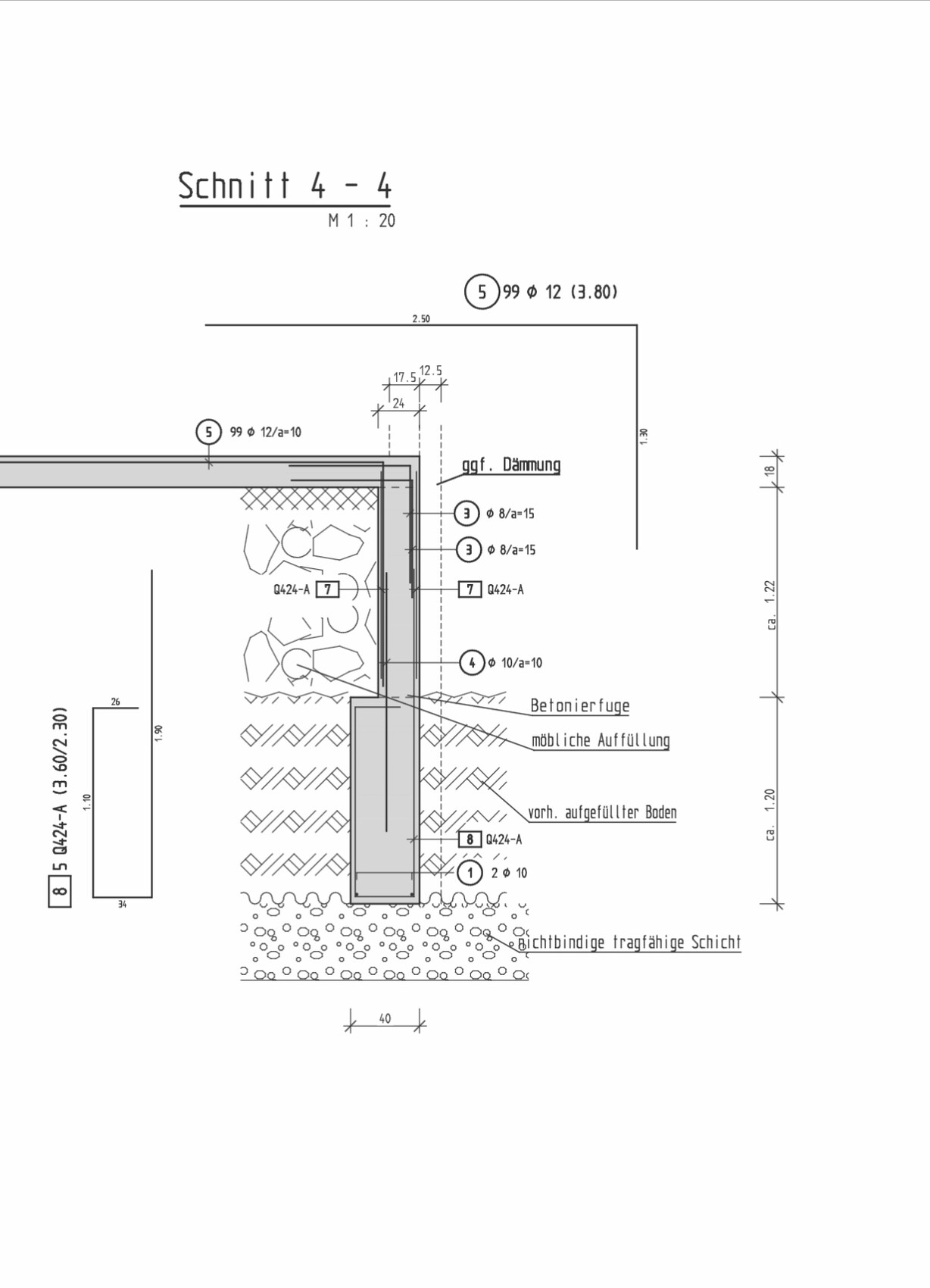

He will probably build a 2.20m (7 feet 3 inches) basement as well, similar to the Viebrock house – based on my civil engineering plans, underpinning work should not be necessary.
However, we will receive his plans soon/sometime so that my general contractor can review them. He expects to start construction in February/March, which would suit us well.

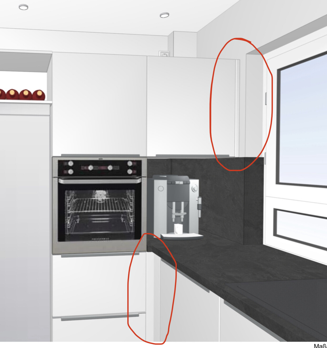

goalkeeper31 Dec 2019 09:04This is how it would look with the two 15cm (6 inches) pull-out pantry units. The sink has not been adjusted yet and would be moved further to the right.
Alternatively, the two circled filler panels could be widened so that the side-by-side refrigerator would be positioned further away from the open dishwasher door. In that case, the 30cm (12 inches) pull-out pantry would remain.
Still a bit undecided.
With the 2x15cm (6 inches) units... storage planning... possibly 1x15cm (6 inches) unit for towels and for storing baking trays and similar items vertically, and the other one for oil bottles and so on. In this case, you might consider skipping the tall pull-outs on the cooktop side and instead plan for 2 drawers and 2 pull-outs. That would give you 4 storage levels instead of just 3.
