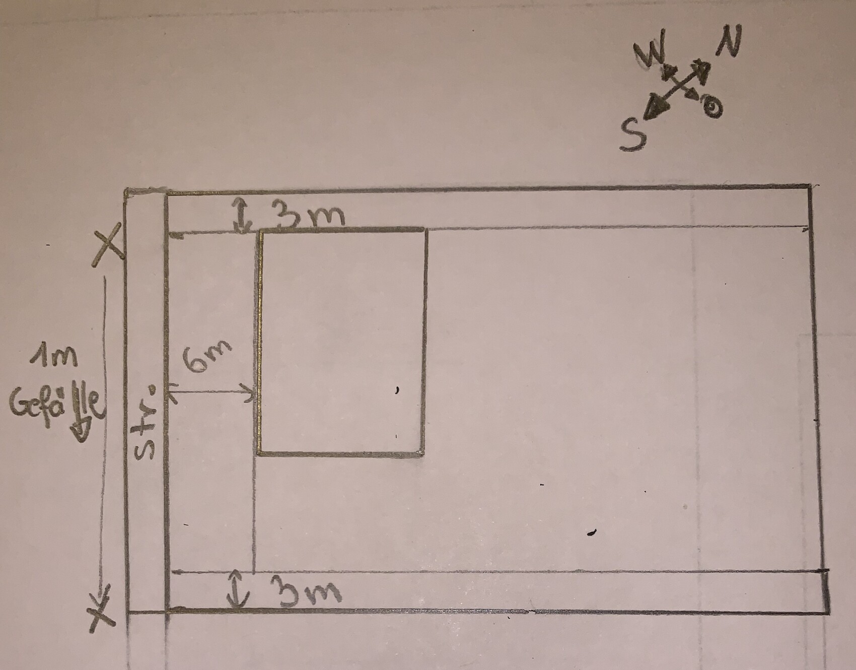

Building line: 6 meters (20 feet) from the street, 3 meters (10 feet) from the neighboring properties.
Slope: Along the street, a little over one meter (measured from boundary to boundary); from the street towards the garden about 2.5 meters (8 feet) until the end of the house – roughly one floor height, after which we can still keep a terrace and some garden before we have to step down further (the second garden level is one story lower).
The main entrance and garage should be on the ground floor. Since we need to stay 6 meters (20 feet) away from the street, there is still enough space here to place a cozy bench for the evening sun (although the sun sets fairly early around 6:00 pm due to the neighboring houses casting their shadows).
On the south side, we could have about 8 to 9 meters (26 to 30 feet) of space for windows in the basement level. Hence the question of where the kitchen would best be located. The window frontage would remain roughly the same. Whether we place it on the large garden side facing northeast or on the south side facing the neighbor doesn’t really make a difference for the windows.
I’ve tried to sketch the slope along the house; maybe that helps? I haven’t drawn the upper floor.
We would prefer to position the house right on the 3-meter (10-foot) border with the northwest neighbor (see picture) to allow for a larger south-facing terrace. There is no west sun anyway because of trees and houses.

hampshire
6 Apr 2019 21:44
I was thinking along similar lines. This approach offers a lot of flexibility and options. I would refer to the ground floor as "Level 0" and the basement as "Level -1," since "basement" doesn't quite fit what you have in mind.
With a wooden deck at Level 0, you can create a covered area over a section of the Level -1 terrace along the retaining wall, while also gaining an evening sun deck that doesn't necessarily have to be at the front of the house.
If you plan to have a garage for a car, it’s worth considering integrating it into the building structure.
I would place the building services in the windowless part of Level -1.
How large will Level +1 be? This could also provide space for an evening sun terrace on the roof of Level 0.
