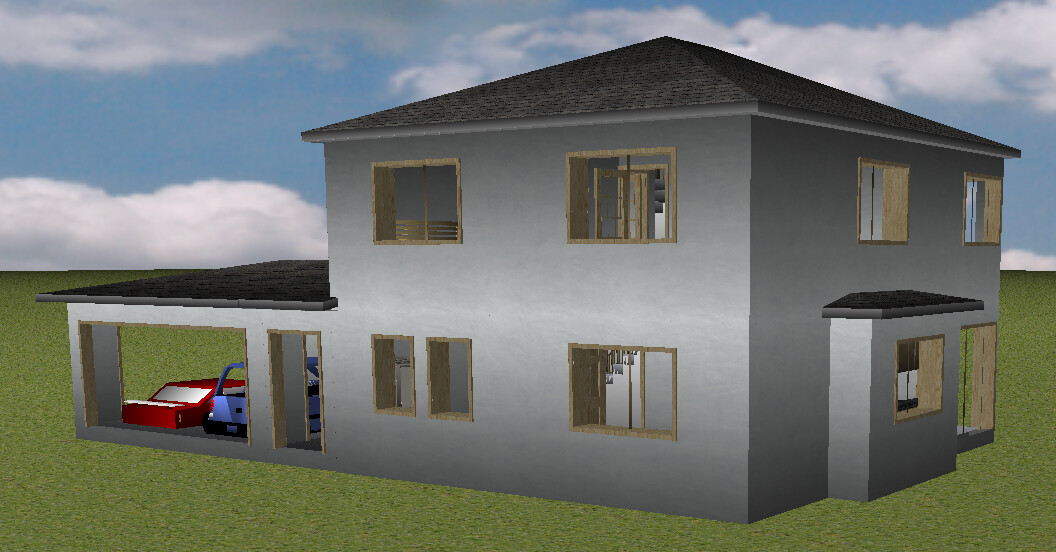

We plan to build a single-family house with about 125sqm (1,345 sqft). We would like to include a small home office on the upper floor.
We prefer not to have the staircase directly next to the front door to avoid having to walk through the “dirty zone” all the time. However, an L-shaped staircase next to the front door might save space. This would allow for a larger utility room (the front door would be moved slightly).
The kitchen cabinet layout is not finalized yet. A place for a fireplace is also still missing (the challenge is integrating the chimney on the upper floor).

What do you particularly like? Why? What do you dislike? Why? The north and west elevations look a bit odd; maybe an additional window should be added there.

Grey rendered house with dark front door and multiple windows under a blue sky
3D house front with grey facade and multiple windows
Two-story light-colored house facade with many windows, view of the front side.
Grey 3D house facade with windows and entrance door, exterior view
