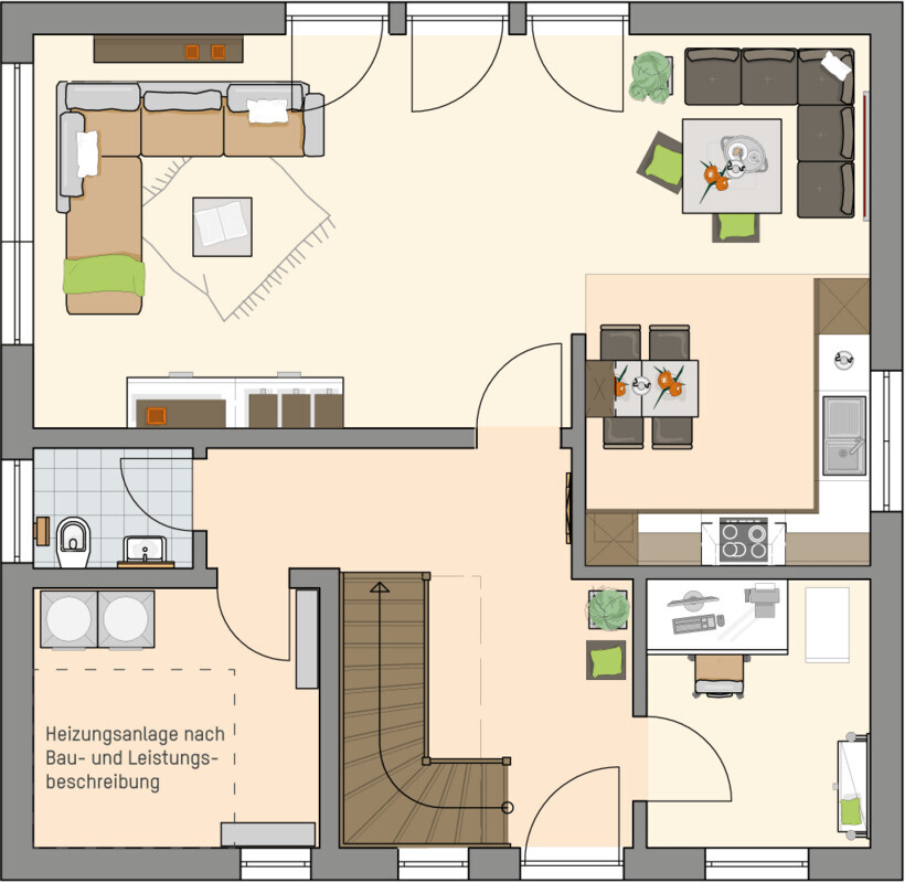

Stefan890 schrieb:
How would you arrange the carport and driveway on the property? [...] At the moment, we are leaning towards an eastern location, possibly slightly in front of the house. What do you think? Stefan890 schrieb:
Carport arrangement:
As shown in the right image, it seems more convenient to drive out that way.
kaho674 schrieb:
Yes, I agree with the east side as well. But the plot is quite tight.
20m (66 feet) - 6m (20 feet) carport - 9m (30 feet) house width = 5m (16 feet) to the fence. Not sure if a terrace is worth it there or if it’s better to have one only on the south side?You’re funny.
If I had spent more time on the forum back then, so had more time for planning, we could now enjoy a sunset drink outside in the evening during summer. Instead, with the south terrace we’re unfortunately in the shade from 7 p.m. onwards. Our garage is located on the northwest side.
As shown in the right picture, it seems more convenient to drive out that way.Doesn’t matter... there are more important things!
Whatever... there are more important things! Yes, if this road is neither a racetrack nor a play street, it can be disregarded. But whether that is the case, I cannot tell from the pictures; I can only see that in the left image, driving forward means driving in and reversing means driving out (or some skillful maneuvering).

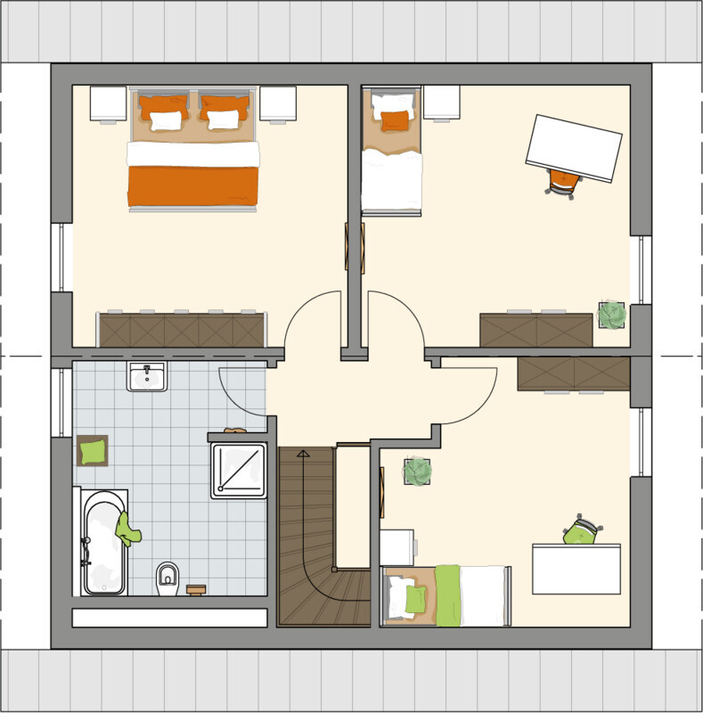

Perhaps the Vio could still serve as an inspiration:
It wouldn’t be my first choice, but relocating the office downstairs might be worth considering for a small house size. However, I have to mention that Fingerhaus advertises the Vio as 140m² (1,507 sq ft). Still, the external dimensions are unlikely to differ much from the original design.
Two living areas side by side? What, if you don’t like each other at all anymore? Who would ever do such a thing???
Well, having a dining area instead of that crazy idea makes it feasible. But seriously, who designs interiors like this?
From time to time, public criticism still seems appropriate to me.
Climbee schrieb:
Two living areas side by side? Is that for people who don’t like each other anymore, or what? Who would ever do something like that???
Well, replacing it with a dining area instead of this nonsense idea is possible. But seriously, who designs such interiors? Sometimes public shaming still seems appropriate to me. Well, hopefully the original poster has the imagination to swap the second sofa for a table. Just like exchanging the dining table for a kitchen island.
Maybe the designer actually intended to draw a corner bench but didn’t have a template in the software.
