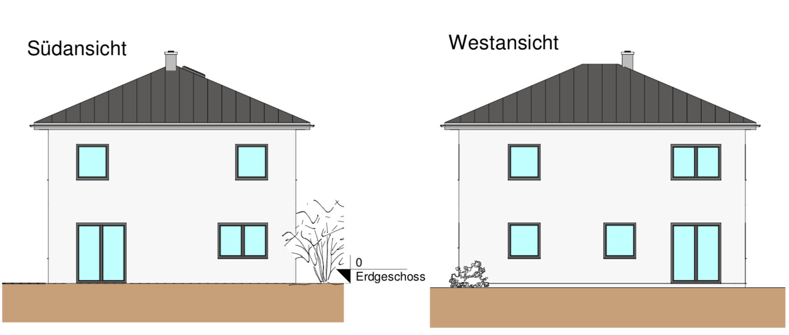

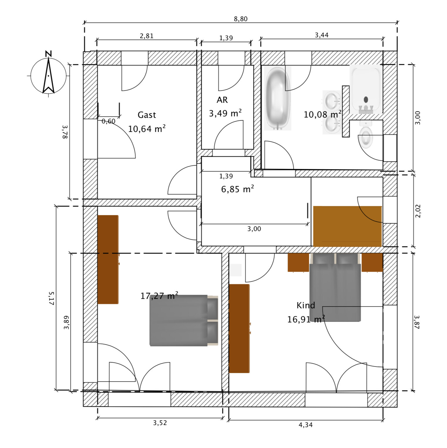

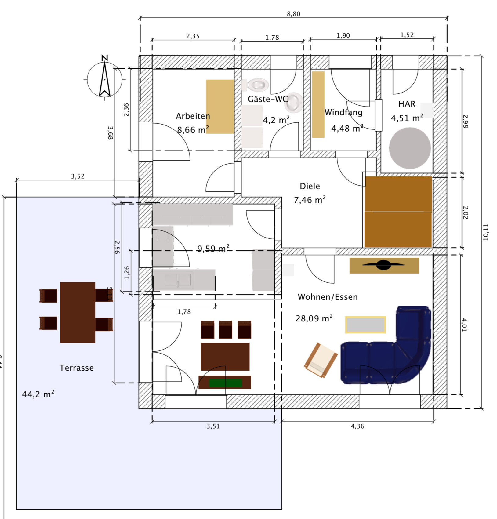

Stefan8908 Nov 2018 22:43Here is an update and our current plan:
Ground floor:
The utility room is designated solely for heating and technical equipment. The washing machine will be placed in the guest bathroom. The staircase is a U-shaped design.
First floor:

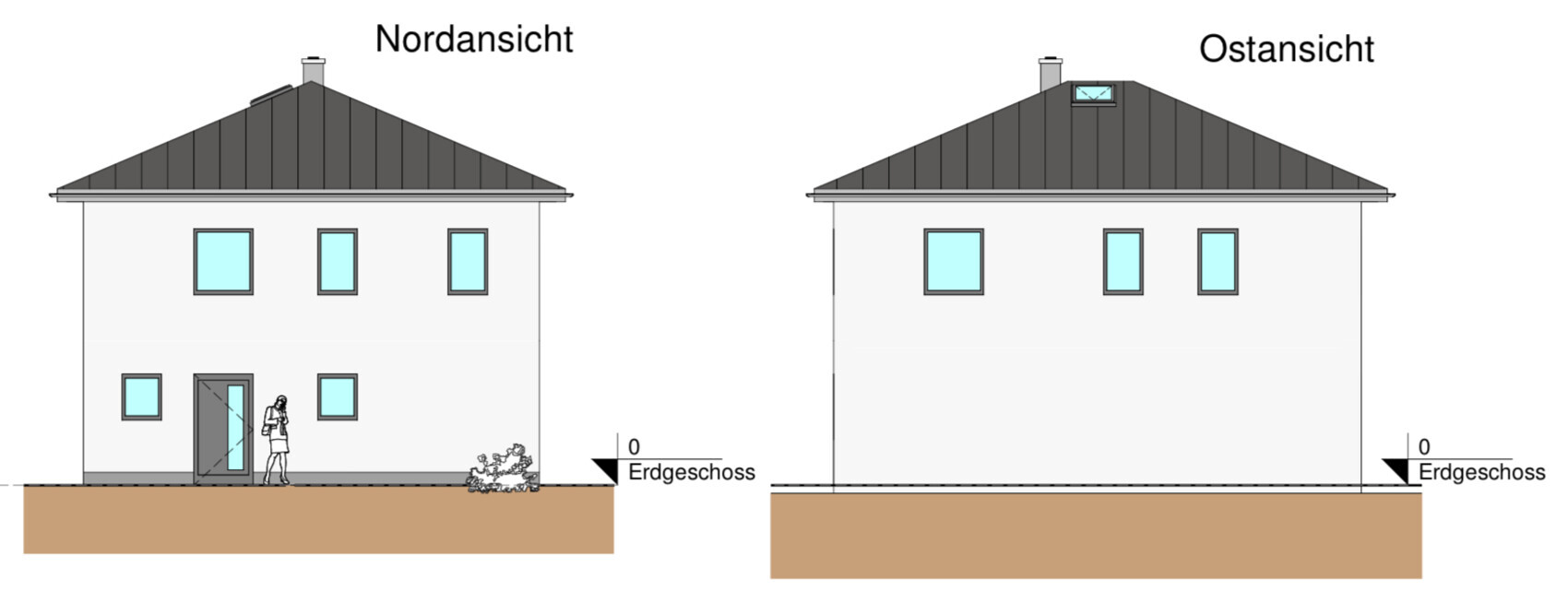

Elevations:
We are not yet completely satisfied with the window arrangement. Are there any suggestions?
Ground floor:
First floor:
Elevations:
