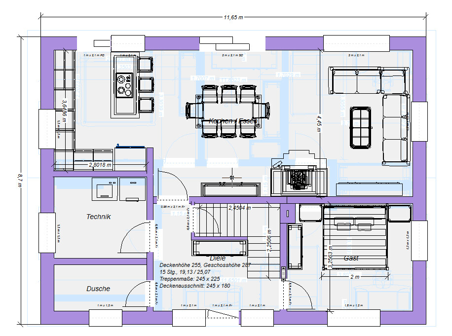

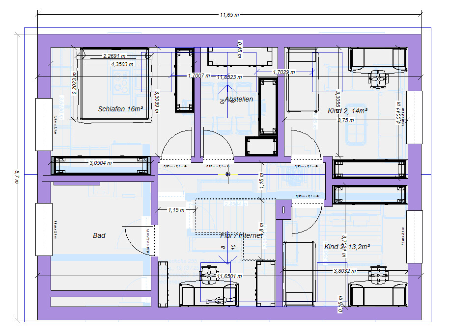

Another version without the kitchen narrowing, which in my opinion provides more spaciousness and room. Access to the technical room through the kitchen has the advantage of also serving as a storage area. A laundry chute in the bathroom is possible.
Children's room increased to 15m² (160 ft²) without significant loss to other rooms.
The chimney is positioned almost optimally just before the roof ridge.

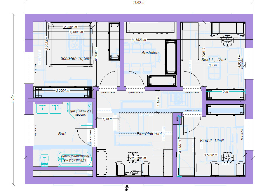

j.bautsch8 Mar 2018 07:10I really like the latest floor plan you shared. I’ve designed something quite similar for myself before (with a bit more house depth), at least for the ground floor, since our space requirements for the upper floor are different.
I also think having the utility room directly next to the kitchen is great. You don’t need constant access to the technical equipment, so its distance from the entrance isn’t a big issue—only storing supplies might mean a longer walk. I’m not sure if it’s possible, but maybe a second entrance to the utility room could be added? Perhaps nearby or connected to the garage or parking space?
