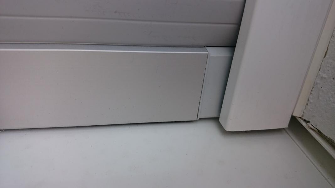

17 Jul 2016 14:01
Attached are 2 photos of the sliding tracks.
One is from my place. These end where the windowsill begins, leaving about 2cm (0.8 inches) of gap until the windowsill where light enters!
The other photo is from the neighbor’s new build, where the sliding track extends almost all the way down to the windowsill. According to the neighbor, there is hardly any light coming through there!
Is my sliding track installed correctly? Visually, it looks “nice” as it is flush with the top edge of the windowsill upstand.
Thank you
erika

Mycraft18 Jul 2016 09:11
Your roller shutter installer should relearn the end points; this should resolve many of your issues.
