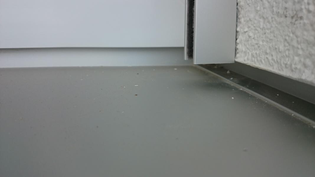

No, this is about the length of the tracks! The slats not closing properly is a different problem! The roller shutter does lower all the way down to the window sill.
I am concerned about the length of the track, where strong sunlight comes through!
At my neighbor’s, the tracks come within 3mm (0.1 inch) of the window sill!
At my place, it’s 2cm (0.8 inch)! So, there are big gaps where the light shines through!

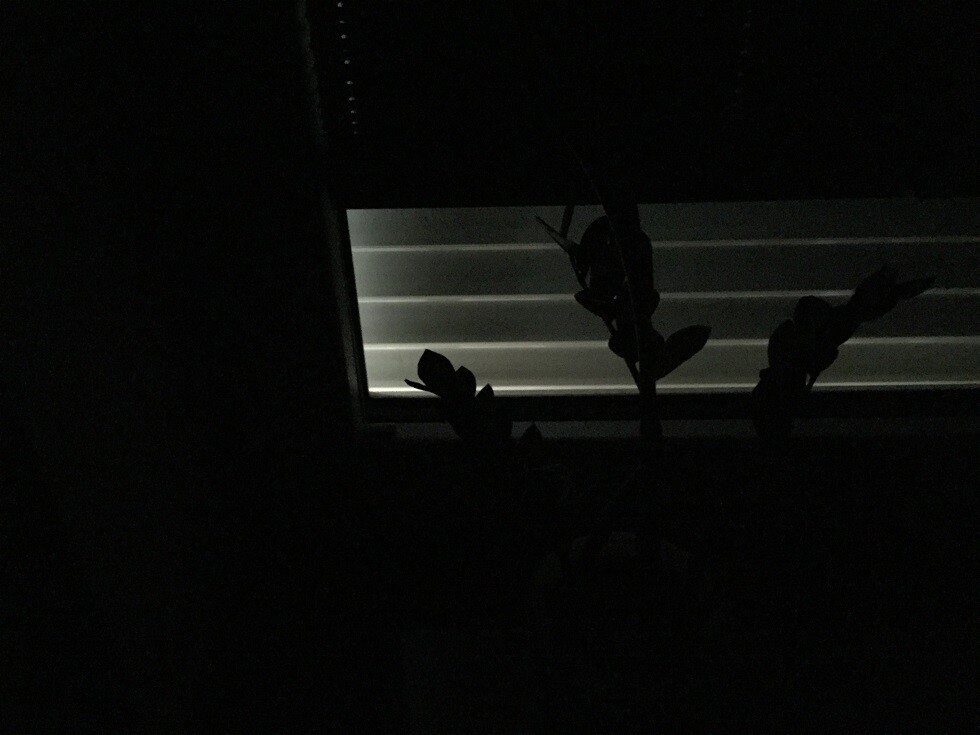

Here is a picture showing the darkness when the roller shutters are closed.
Although the shutters close down to the brickwork, some light still gets through. However, it is fairly limited. If they do not close all the way, quite a lot of light enters. Something went wrong there.
I have never heard of manual strap-operated roller shutters being considered an emergency exit option. The plastic slats can be broken out with a strong kick, or they can still be raised. If this is a regulation in Bavaria, of course the contracting party must pay for the proper installation according to the rules (unless they can prove that you as the builder knowingly intended to disregard this regulation).

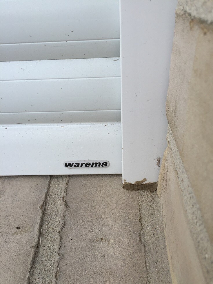

The shutter does close all the way down. But my problem with the roller shutter installer is the aluminum guide rails!
In my case, they only go down to about 2cm (1 inch) from the bottom (see photo).
At my neighbor’s, they come almost down to the window sill—about 2mm (0.08 inches) clearance.
Most of the light comes through this gap!
Also, light leaks through the slots between the wall and the aluminum guide rails!
Altogether, it’s been very bright in the bedroom from 5 a.m. during the summer!
