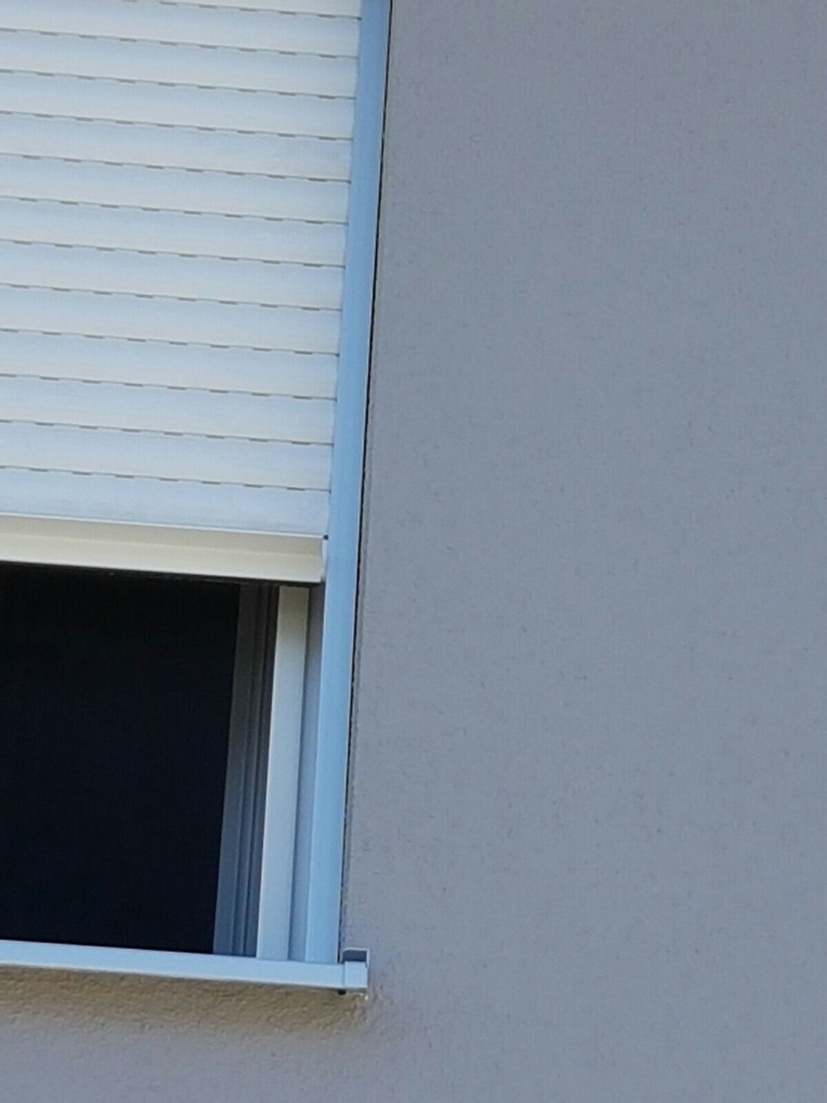

fraubauer1 Aug 2016 09:20ypg schrieb:
wouldn't it have been appropriate for you to share this information with us? We live and learn here only from each other’s experiences.
The next user with the same problem will be grateful to read your info. And we are too, since we are dealing with your issue.
I’m curious how the agreement with the roller shutter installer looks now?Good morning.
The issue with the roller shutters in my new condominium just won’t end...
I visited the roller shutter installer in person on Saturday and explained my problem again, showing photos that prove I get a strong light influx in the bedroom starting at 5 a.m.
I also mentioned that according to another installer, no compression tape was installed between the wall and the guide rail on mine! Also, the guide rail does not extend all the way down to the window sill but stops about 2.5cm (1 inch) before it! All of this contributes to a significant amount of light coming in (because it’s the east side) in my room!
The roller shutter installer’s (a long-established local specialist company) response was:
“All installations were done according to standard”
“There is no white compression tape, only black, and that doesn’t look good”
“If compression tape is installed, the shutter curtain might get pinched”
“Installing compression tape could push the aluminum rail or anchors out”
“The aluminum rails must be mounted above the aluminum window sill”
“In the attic floor, the masonry/plaster was done very precisely, so there’s no gap between masonry and rails. On the upper floor (where we are), the work was not done as precisely, hence the gaps”
In summary: the roller shutter installer is not addressing the problem at all!
For 6 weeks now, I have been covering the window from the inside with cloths and sleeping with a sleep mask.
I’m slowly getting desperate.
PS: I am the only one affected in this multi-family building because I’m the only one with an east-facing bedroom.
The photo shows the gaps between the wall and the guide rails.
The guide rails do not reach down to the window sill as the photo suggests! There is a gap of approximately 2.5cm (1 inch)!
erika

fraubauer schrieb:
The running rails do not go all the way down to the window sill as the photo suggests! There is a gap of about 2.5cm (1 inch)!Didn’t we already mention that this is normal? We also have a 3cm (1.2 inches) gap to the window sill, but I think I wrote that somewhere.
