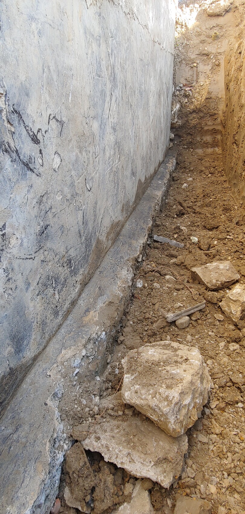

Regarding point 1: It will be difficult to remove the old material, that is, the existing bitumen coating. I will do my best. How should I treat the scratches (which can also be partly seen in the next picture) before applying the thick coating here?
Regarding point 3: Here is a picture of the foundation:

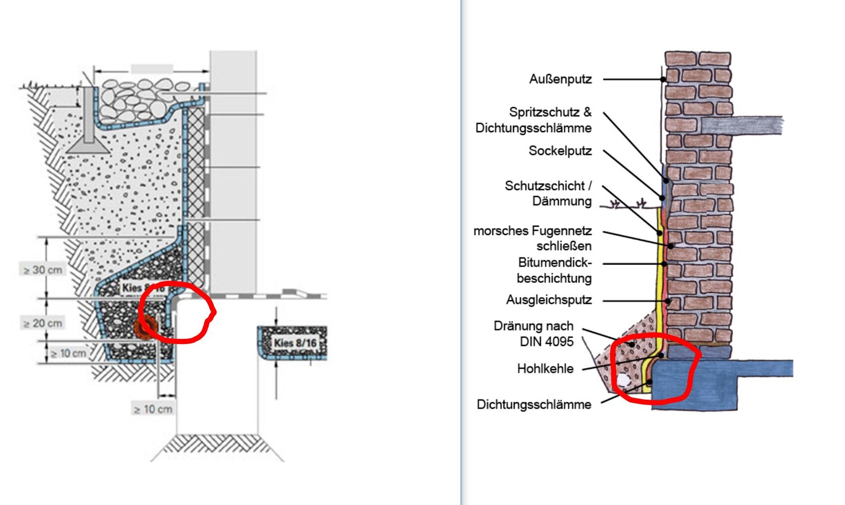

Should bitumen also be applied on the side of the foundation? It is very rough. Unless something else is meant to be applied before that. Here is a drainage setup, where many tend to partially seal the foundation as well:
