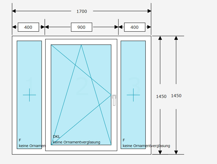

We are mainly getting windows sized 1.45m x 1.7m (H x W) (maybe only 1.35m x 1.7m on the upper floor). The height is more flexible, but I wouldn’t make half steps in the width, like 163.5 or 176.
denz. schrieb:
They have to be double-leaf windows. I thought I now have the choice between a mullion or a French casement. Are there other options? No, why? – I’m not sure where I might have confused you: double-leaf windows are only possible with or without a mullion. But some people don’t consider this and plan with a mullion by default, then they are told that the emergency exit window has to be an exception (to reach a clear opening width of 90cm (35 inches)).
But there are people who don’t consider this and by default plan with a central mullion, only to be told that the emergency exit window must be an exception (to achieve a clear opening width of 90cm (35 inches)).There is no rule without exceptions. The 90cm (35 inches) requirement comes from the fact that about 40cm (16 inches) is taken up by the ladder and about 40cm (16 inches) is needed to climb out. However, there is an option to get a relaxation for windows with a central mullion, since one side of the mullion can be used for the ladder and the other side for climbing out. Even for 80cm (31 inches) without a central mullion, an exception permit can be granted if the window height is appropriate. There was a report about this in one of the recent fire protection issues.

We are mostly getting windows measuring 1.45 m x 1.7 m (H x W) (maybe 1.35 m x 1.7 m on the upper floor). These need to be double casement windows. I thought I had the choice between a central mullion or a French casement. Are there other options?You have a comfortable 90 cm (35 inches) opening, and you can fully place furniture on the sides without any issues. On the ground floor, cleaning from outside should not be a problem; on the upper floor... well, 40 cm (16 inches) is still manageable.
Stretching the window and the overall look is advantageous since it uses two fixed panes (cheaper than a French casement with two 85 cm (33 inches) sections).
Even more elegant is the 185 cm (73 inches) width with a 105 cm (41 inches) central opening.
