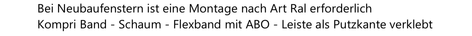

What was used in your case? There are various options for RAL-compliant installation (triple-compression tape, sealing tapes, plaster sealing profiles).
What didn’t work for us, for example:
- Support blocks either completely forgotten or just cut from a random roofing batten (spruce/pine)
- Fastening not done continuously around the perimeter
- Wrong compression tape used (2-4mm for joints of 5-15mm) → fills the gap but is not resistant to driving rain
- Wedges “forgotten” and removed later (foam is missing there now)
- Surface under sealing tape not cleaned/primed (tape doesn’t adhere)
- Fastening tabs not fully covered with sealing tape (leak at resulting “hole” next to the tab)
- They initially wanted to leave out sealing tape at the bottom (“The window sill will cover it anyway”)
- Sealing tape not properly glued at the corners, with obvious holes later half-heartedly patched
- Sealing tape on the outside at the bottom not correctly overlapped and not shaped as a “tray” in some areas
- Sometimes wrong screws/dowels used (Poroton has different requirements than, for example, sand-lime brick)
- Sealing tape sometimes installed without a movement loop
- For the wooden dormer, sealing tape was used for plaster embedding
- Compression tape partly not fixed and later bulged outThis is how it is written in the offer and how it was also installed.
