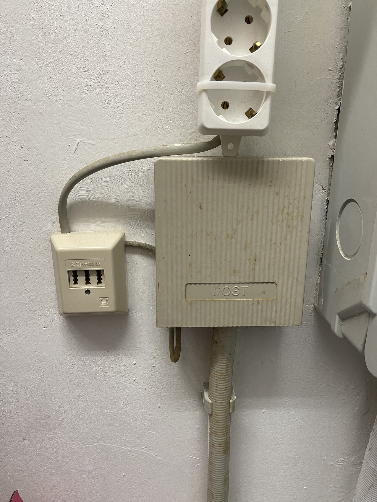

Schimi1791 schrieb:
The house connection is in the basement. You could also go out directly from there. But the router is located in the living room. Is it connected to a TAE socket or something else?

The system still works today 😉.That sounds reassuring 🙂Here is a photo of the utility connection:
Primitive but functional. There is another TAE socket upstairs in the living room where the router and phone are connected.
