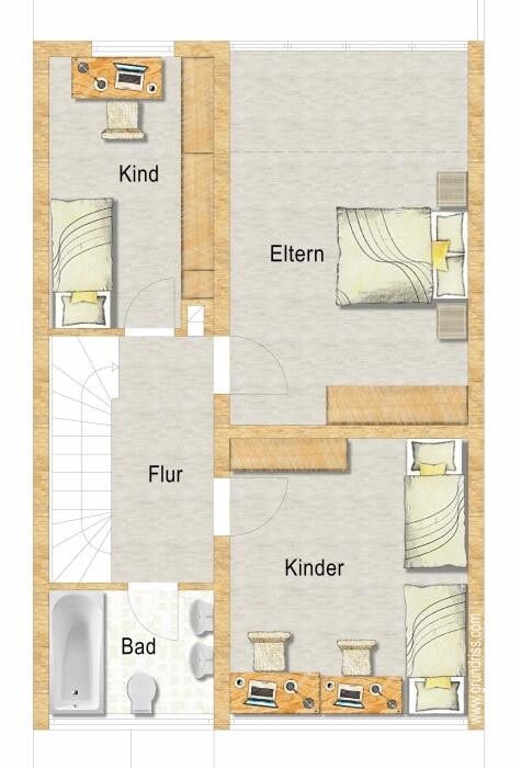

The bathroom is on the east side of the upper floor (relatively small, about 4.5 sqm (48 sq ft)) with a bathtub (picture 1), which we would probably replace with a shower. We hardly ever use the bathtub and I find bathtubs less suitable for showering. Besides, this would gain us some extra space.

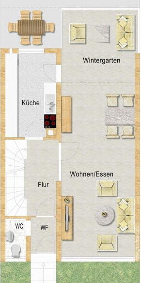

Directly below it is the guest toilet and below that, in the basement, a storage cellar (see floor plan, picture 2). According to the floor plan, it has the same dimensions as the bathroom upstairs. So my question is whether it would be possible to install a second bathroom where the storage cellar currently is. I’m not sure, but I assume the water pipes and drains should run inside the walls anyway, since there is a guest toilet and bathroom above.

What is supposed to be recognized here? These could be different floors or even separate houses. As it stands, the question doesn’t make any sense.
Please upload the complete plans, showing where the rooms are located, where a bathroom already exists (and thus the plumbing installations), and where adding another bathroom might make sense.
I have many talents, but unfortunately, I still haven’t mastered the art of crystal ball reading...
Costruttrice11 Oct 2021 10:23As you already mentioned, for a bathroom in the basement you need to consider the sewer level or the sewer connection. If the sewer is located too high, you will need a lifting station; for the toilet, a special sewage lifting station is required, while for the sink, shower, and washing machine a grey water lifting station is sufficient.
