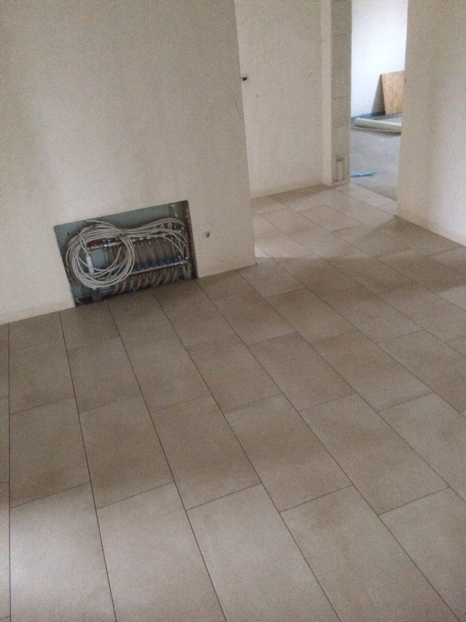

30 Aug 2020 21:45
The 60 by 30. Around 22 per square meter.
Cable distribution box in the wall with coiled cables; tiled floor.
Shell bathroom with white tiles, pipe connections, and a bucket on the floor.
