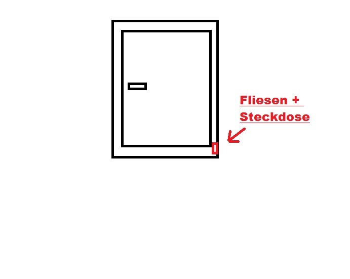

Hey,
the question is basically already in the title.
How much space would be optimal for this? Maybe some of you also have pictures to share?
Thanks
Thanks
We also have electrical outlets installed in the window recesses, and I find them terrible... they can be handy for Christmas lights, but as soon as something is plugged in there, it’s almost impossible to open the windows.
If I add a remote control plug or a timer to the outlet, the windows won’t even tilt open properly anymore. My wife especially likes to fling the windows wide open, no matter how many times I’ve told her to be careful...
This is especially problematic in bathrooms, where the recess is tiled and an outlet is installed; the space can become very tight. In our guest bathroom, for example, the window can’t be opened a full 90 degrees because there isn’t enough clearance.
