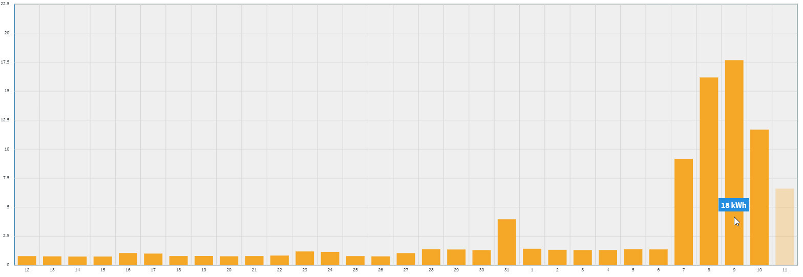

Okay, as I suspected, there was a wiring error with the power measurement outlets — the ventilation system was connected behind the heater, which of course doesn’t make any sense 🤨
So the heater is not consuming excessive electricity. According to the app, it may use about 15-20% more than usual, which is completely fine (around 0.8 kWh per day).
All the more frustrating is the power consumption of the ventilation system. 😡 They could have simply used an air well or something similar, and this problem probably wouldn’t exist. Now, the controlled residential ventilation system is currently using about 800-1000 watts during operation (at -12°C (10°F) outside temperature). I have set the airflow back to the factory default of 150 m³/h (88 cfm) under normal operation, hoping that air quality won’t suffer too much — but the air quality sensor will tell me… and my own nose will probably notice, too.
Attached is the electricity consumption, which has significantly increased since temperatures dropped below freezing.
jeti79 schrieb:
You would have only needed to use an air well or something similar, and then this problem would more or less be a thing of the past. That gives you a project for the summer.
Mycraft schrieb:
That gives you a summer project.Unfortunately, it won’t be that simple for me: The mechanical ventilation system is located in the attic, and we have underfloor heating throughout the house. So getting through the house will be difficult. You would have to somehow go through the garage and the exterior wall, and I assume that over the length of that connection the "air purification and tempering effects" would be minimal and unlikely to succeed. This just wasn’t planned, and the plumber is not familiar with this kind of setup, for example.Similar topics
