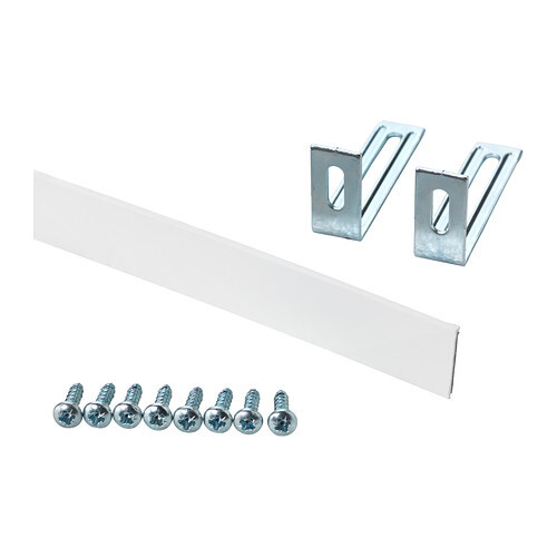

2) It might be a baseless prejudice, but I wouldn’t necessarily buy a Turkish refrigerator. In any case, I would look for reviews of Beko products. You can adjust the base panel height accordingly; if necessary, you might have to drill new holes since the hole spacing for METOD is relatively large at 5cm (2 inches). There is nothing problematic with the doors. There are only
