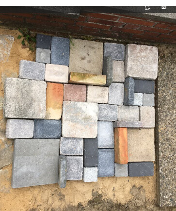

Chrisu17034 Aug 2016 10:41Hello, the house is about 70 years old, and I suspect that the exposed aggregate concrete slabs have been in place for several years, possibly decades. I’ve laid out one square meter for you ... this is roughly how I imagine the pathway ... basically, I assumed a level installation, although I think a natural look will develop anyway since I’m handy but have never installed paving before ;-) .
Chrisu17034 Aug 2016 14:09Thinking very simply: with a lot of patience, the bricks are placed in the sand at varying depths depending on their size...
Sebastian794 Aug 2016 14:22Then give it a try – you’ll never get it properly clean that way.
