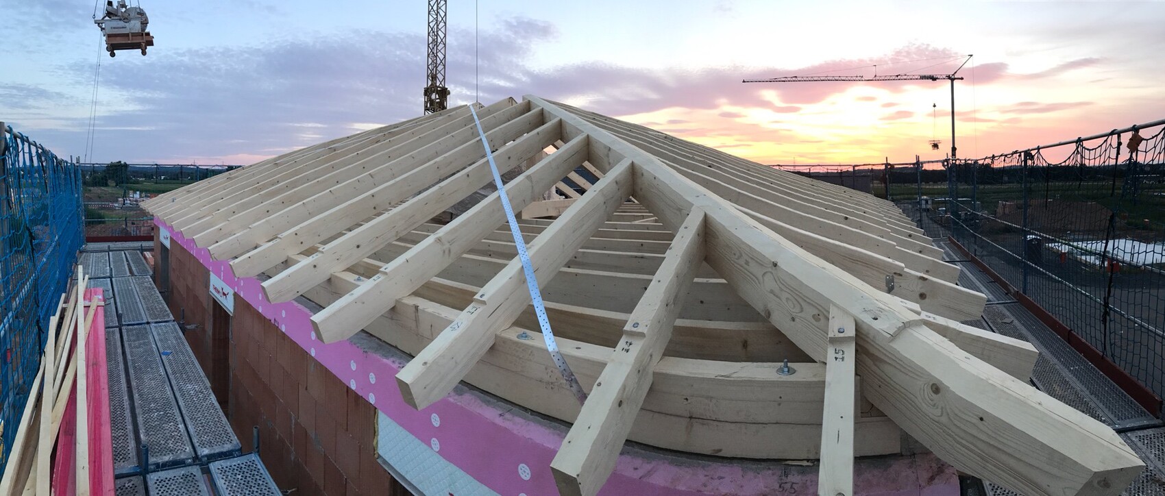

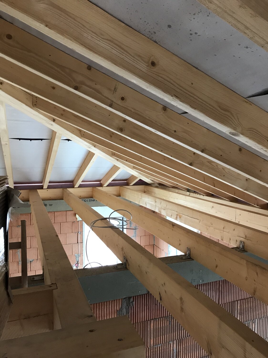

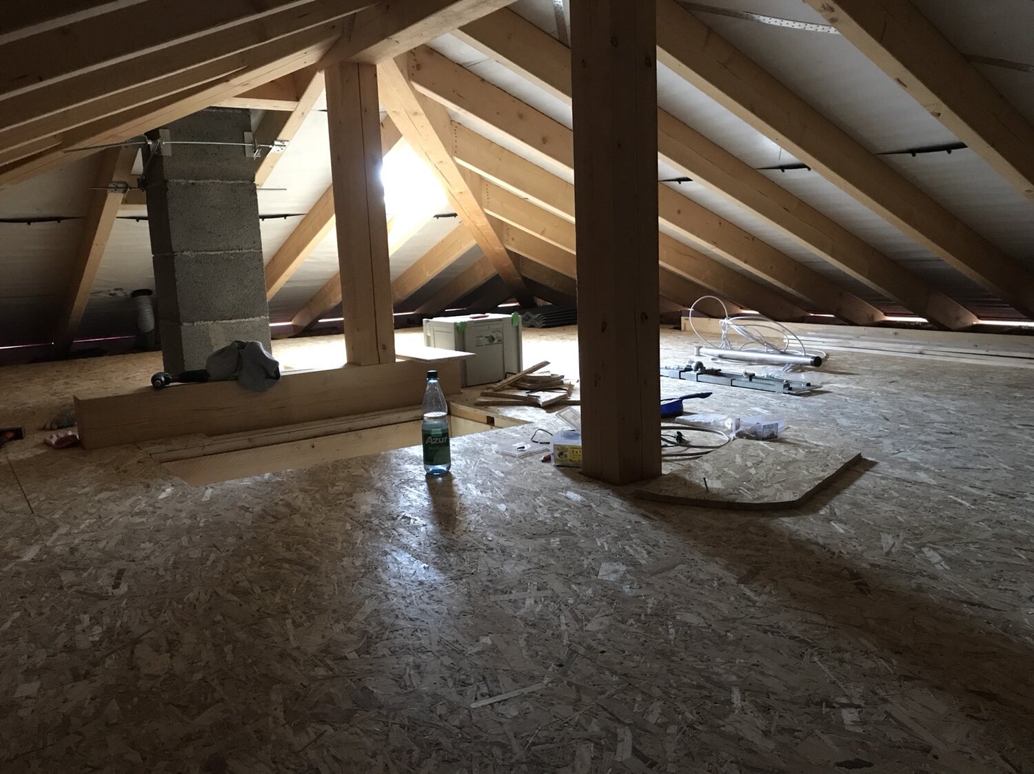

In my opinion, there is no advantage to having a second concrete floor in a “town villa.” This is what it looks like without insulation and once finished, ready to use (22° pitch):
What does a solid concrete ceiling really provide? To be honest, not much at 22°C (72°F). If you have attic conversion potential, it might make sense. Otherwise, for example, the ring beam is practically always present—just once with the ceiling, once without. It is necessary, however, to stiffen the building. Then there are the collar beams above it. Insulation is easier from below, by the way. And installing the vapor barrier is not a big effort.
