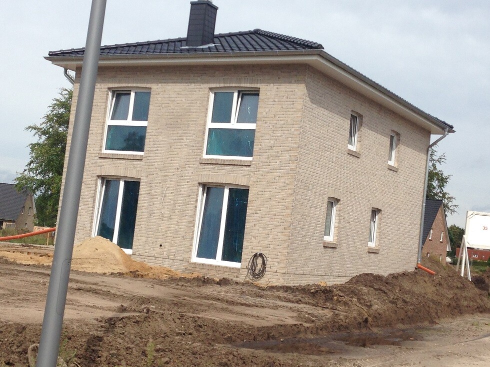

We have a townhouse with similar dimensions (8 x 10.5 meters) (26 x 34 feet). On the south side, we installed two double casement windows both upstairs and downstairs, with a fixed lower window chosen for the upstairs.
Advantage of the divided upper floor-to-ceiling window: you don’t need a grille in front of it, which can sometimes look unattractive.
Disadvantage: you can only tilt the upper window a small amount for ventilation, and to clean the lower window from the outside, you either have to lean over from the front or access it from below.
Because of the ventilation system, we hardly ever open the windows anyway. The children’s room also has another window, as you can see.
With a townhouse, it is very important that the window placement looks symmetrical from the outside. Otherwise, it quickly looks quite odd. It’s best to visit new housing developments and look at townhouses. From my current window, I can see two townhouses that were clearly badly planned.
