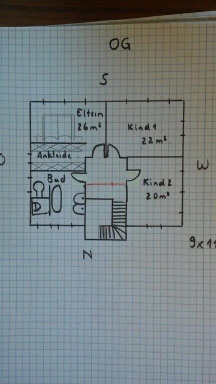

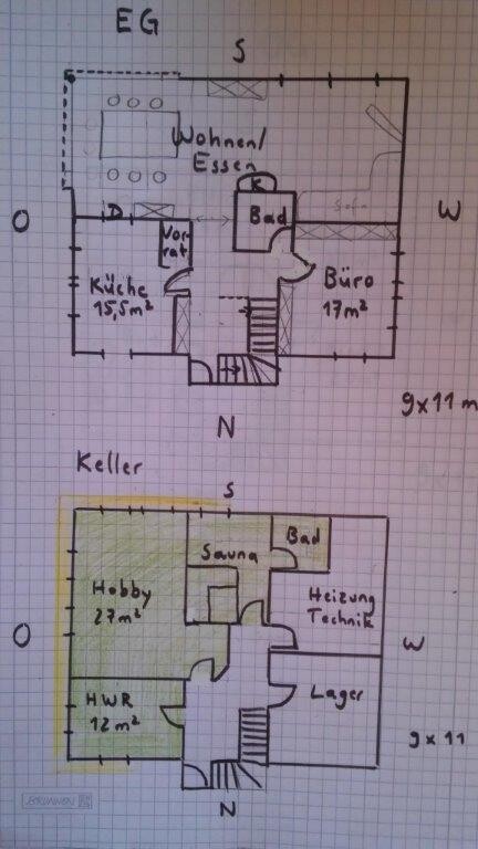

I recently joined the forum because we plan to build within the next 2 years and want to optimize our floor plan before moving into detailed planning.

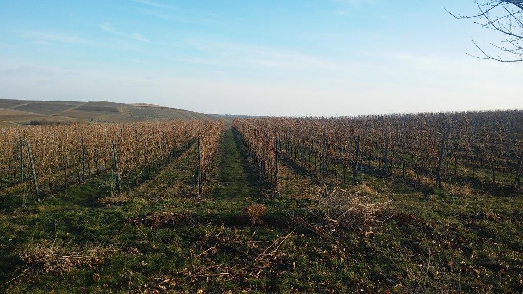

Slight slope descending to the east (see photo)

The basement may later be used as a retirement apartment (green area) and is level with the ground on the east side. The ground and upper floors should be separable later. A terrace is planned on the southwest side.
Who designed the plan: DIY
We want bright rooms but have also paid attention to having enough storage space.
What do you dislike? Why?
We need quite a bit of space on the ground floor, so the rooms upstairs are too large.

Since the plot is on a slope, we would terrace it or build retaining walls with fieldstones so that the front door is at ground level right next to the stairs. The windows that you look out from the sofa should also be at ground level, allowing direct access to the garden. The interior dimensions of the house would be 11 x 9 m (36 x 30 feet). I need to draw the interior walls thicker. I’ll move the bedroom for now...

Try searching for “zero barrier” accessibility. The floor plans are not wheelchair-friendly. I assume you want to plan for it in case one of you needs a walker or even a wheelchair and a home care service comes to assist.
It sounds like there will be a lot of filling, excavation, and retaining walls involved. That will cost quite a bit of money.
Do you really need the hobby room, for example? By arranging the rooms thoughtfully, you might be able to reduce earthworks, slope stabilization, and so on.
Mentally replace “basement” with “lower ground floor.”
Don’t plan for too many contingencies. The missing bedroom on the ground floor in scenario X could be created by partitioning the living room.
Maybe in 50 years you will be living in the house as just two again. You should also be able to add an extension. Boundary setbacks shouldn’t be a problem for you.
About the floor plan:
Ground floor entrance
The staircase is right inside the door. Very cramped. No cloakroom. Four people need space for shoes, jackets, stroller, etc.
I would separate the entrance’s dirty zone from the staircase. Are you really going to walk through the entryway only in slippers or socks?
The pantry is too narrow. The freezer door won’t open.
The bathroom can’t fit a shower and isn’t accessible.
Upper floor
The bathroom layout could be improved. A bathtub in the middle of the room and the heavily used toilet moved to the farthest corner.
Plan the children’s room doors so that a wardrobe fits behind them.
What do you think about having a laundry room on the upper floor? Washing clothes where they are used.
Some doors are too narrow, probably around 75 or 80cm (30 or 32 inches).
Upper floor
