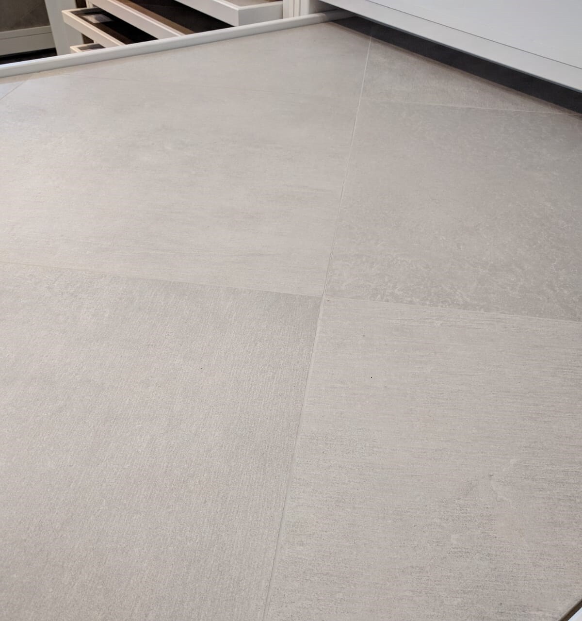

14 Sep 2018 09:01
nordanney schrieb:
How do you lay square tiles crosswise?
The 60cm x 60cm (24in x 24in) tiles do not necessarily have to be laid in a straight grid (stack bond). They can be installed diagonally or in a staggered pattern (running bond).
Climbee schrieb:
Grout lines always get darker where people walk
They should become slightly darker but not completely dark, I specifically asked the tiler about this. You should also pay attention to the cleaning products used, according to their statement.
Here is a picture
Light gray floor covering made of tiles with a fine texture in the kitchen area next to drawers
bibi80
