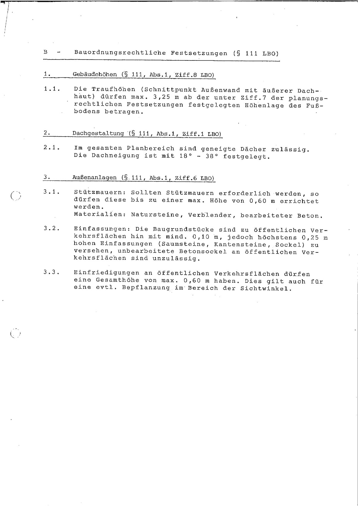

Here are the development plans.
Is this sufficient or do you need more?
Document page with planning regulations: scope, use, and dimensions.
Scan of a land-use plan document with construction regulations: building type, boundaries, utilities, elevation.
Page from planning documents with regulations on building heights, roof pitch, and outdoor facilities.

Yes. Important details like the finished floor height 60cm (24 inches) above the original ground level and retaining walls with a maximum height of 60cm (24 inches) could have been provided first.
Who changed the direction arrow of the ridge? It was originally parallel to the street. Please clarify which applies.
With a floor area ratio of 0.3, the bungalow might end up being quite tight.

The ridge direction is parallel to the street
hanghaus2000
23 Jun 2021 14:01
That’s not bad, since the plot is only slightly sloped. But it also means that your floor plan is useless.
