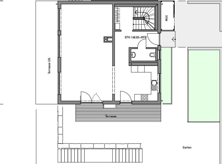

Zenjamino22 Mar 2022 09:06So, I would make one level of the terrace up to the wall between the two doors, which corresponds to an area of about 20 sqm (215 sq ft), then a step with a height of 15 cm (6 inches), and then another approximately 15 sqm (160 sq ft) leading to a paved path towards the garden. The retaining wall next to the house is 4 m (13 ft) long and then about 8 m (26 ft) towards the garden.
There is no space for a path next to the raised area, but maybe enough room for a few flower pots.
Attached is an image from the building permit application (the terrace is drawn too small there).
The question is whether it is even possible to support a 20 sqm (215 sq ft) stone terrace with a 15 cm (6 inch) curb.
