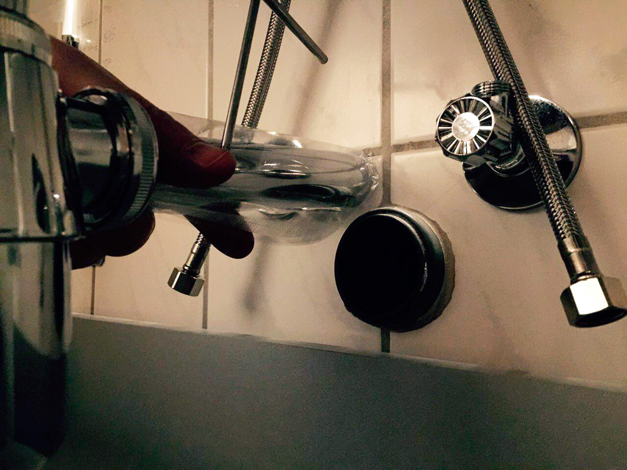

I have an issue with the trap of my washbasin. The pipe that needs to be connected into the wall is positioned too high. Unfortunately, the trap cannot be installed any lower because it would then block the drawer, and it cannot be lowered further anyway. Could you advise me on which angled fittings I need to compensate for the height difference? If you need any additional information, please let me know.

Maybe a space-saving trap or a washbasin cabinet trap will help you.

Bieber0815 schrieb:
Maybe a space-saving trap or a vanity unit trap could help.
Probably not, since these traps are very difficult to maintain and can only be opened with great effort, for example, if something falls inside. Besides, I already have a trap.

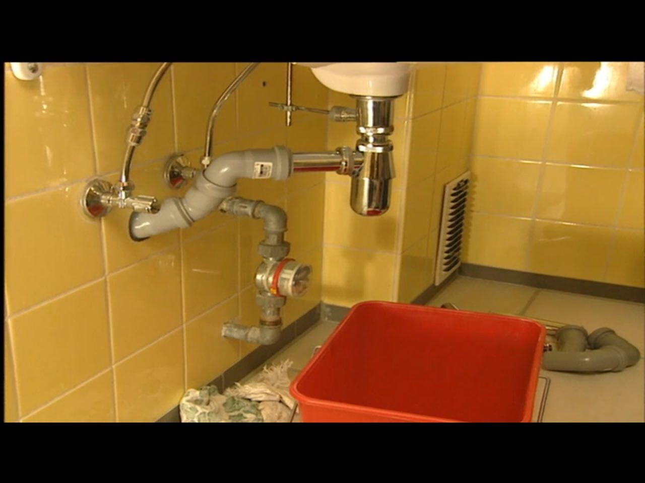

I was thinking more along the lines of this:
Drain pipes and trap visible under the sink against a yellow tiled wall.
How can I determine which angled fittings I need?

Anneken schrieb:
10 euros is too expensive for me, too
How long have you been dealing with your problem? Calculated by hourly wage, it’s certainly more expensive than €10.00 ;-)

With two 45° or 0.67° sanitary tee bends, that should work.
The one in the second photo is very maintenance-friendly indeed.
