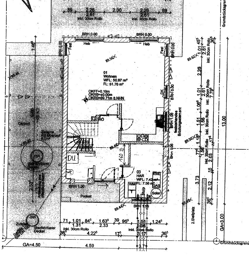

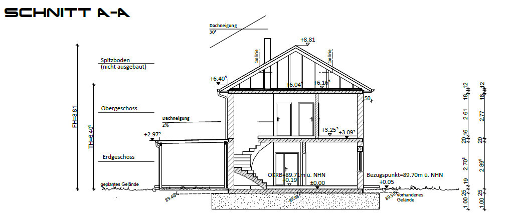

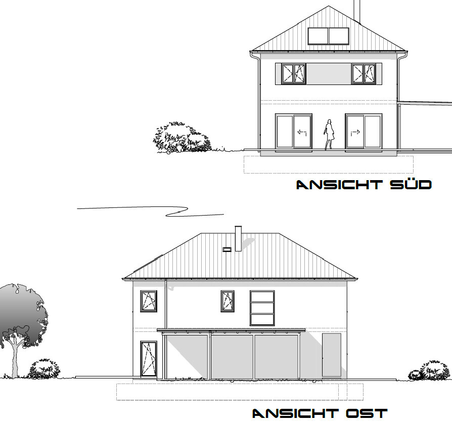

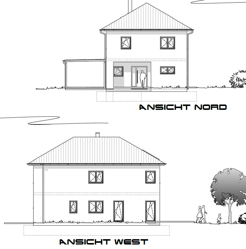

Hello, we are currently trying to decide between a wooden or a steel staircase. What is your opinion on this? Is it ultimately just a matter of personal taste (and budget), or are there specific advantages and disadvantages?
The building will be a 160 sqm (1,722 sq ft) urban villa.
General comments on the floor plan are also welcome. We have redesigned the ground floor ourselves (more storage space in the utility room), which is why there are two versions of the ground floor plan.
Thanks a lot for your input!

16 Oct 2016 13:12
I would align the two bathroom windows on the same level, and position the utility room window at the front to match the height of the toilet window.
On the west side, remove the utility room window (this probably belonged to the original design before the changes took place).
Then, make the children's room windows the same width as the patio doors.
The stair window doesn’t seem to fit - maybe replace it with two small windows like the toilet window, or a shape similar to a narrow patio door?
Stairs: wood seems more traditional to me, steel more modern.
Be careful to install the technical equipment in the uppermost corner of the utility room!

I would align the two bathroom windows, and position the utility room window on the front facade at the same height as the toilet window.
Remove the utility room window on the west side (this was probably part of the original design before the changes?).
Then make the children’s room windows the same width as the patio doors.
The stair window doesn’t quite fit – maybe replace it with two small windows like the toilet window or a shape similar to a narrow patio door?
Stairs: wood is more traditional in my opinion, steel is more modern.
Make sure the technical equipment is installed in the upper corner of the utility room!
