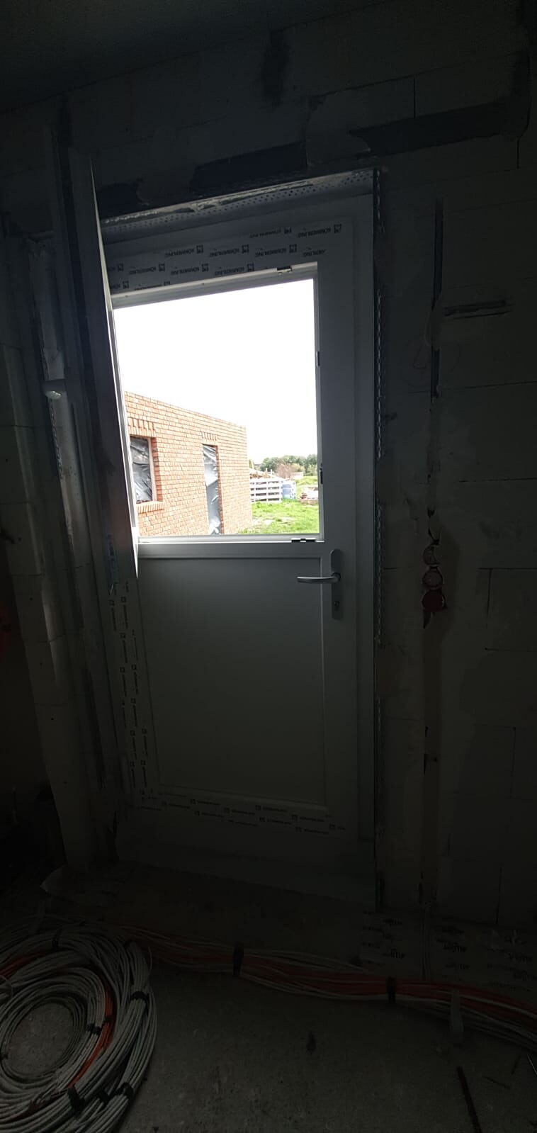

We are making steady progress with the planning. Our utility room will be relatively small (which is fine, it doesn’t need to hold much). However, we plan to install a door leading outside, so that later on we can access the utility room directly from the garage or carport. This way, coats, groceries, and dirty shoes can be left there without carrying everything into the hallway. The problem is that the door can only be placed where there is currently a window. A utility room without a window would be impractical, since the washing machine, dryer, and air-to-water heat pump will be located there. So ventilation is really a must.
Our ideas to solve this problem are the following:
Either install the smallest possible window, or is it possible to have ventilation just for this one room? Which option would be more cost-effective? Or do you have any other suggestions?

pagoni20206 Dec 2020 11:31A room that is clearly so heavily "used" should definitely HAVE at least a decent-sized window
...just that alone... plus the other things. Either the ventilator runs frequently and/or you have a window. Otherwise, it will start to develop a musty smell eventually...

MiCasaEsSuCasa6 Dec 2020 21:15Vario123 schrieb:
We had the same "problem" and decided on a "talk door." This means you can tilt the upper part of the door like a window or open it completely—a great feature.
Yes, that would be great! Was it easy for you to find one of these, or did you have to search a long time for a company that supplies and installs them?
