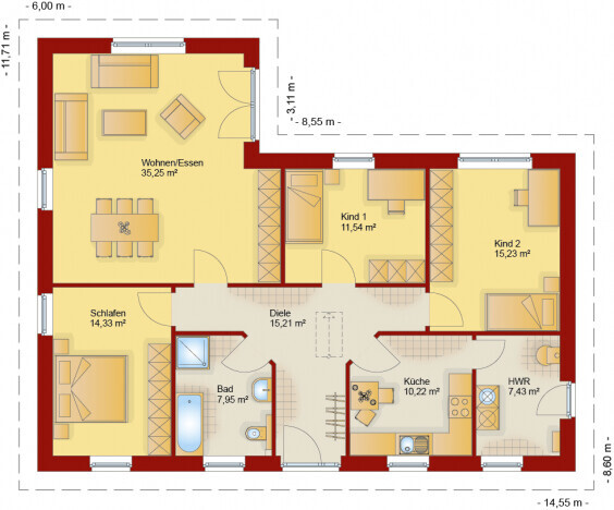

Josilicious9 Aug 2016 21:07These are the dimensions of the bungalow, and with the home builder we have chosen, we could adjust the width to fit the plot. The only requirement is to keep the total living area.
Am I missing something? They would surely be careful if we decided to rotate and modify the floor plan.
