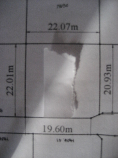

Hello and thank you first of all for your assessments.
I have posted the plot again with measurements. The top of the plan is north, the bottom is south, and thus the street is located there. The house dimensions are 10 x 9 m (33 x 30 ft).
The garage is planned on the east side for better light, with the garden and terrace on the west. If we place the garage northeast, then the driveway will be very short. According to the development plan, the garage must be built with a minimum distance of 5 m (16 ft) from public areas, while carports are allowed to be closer. The edge building line may be up to 9 m (30 ft) in total.
The idea behind rotating the house was to possibly place the entrance on the eaves side, achieving a different floor plan.
We intentionally designed the kitchen to be small, as it is meant to be a utility kitchen. The office is intended as a multipurpose room, also serving as a cellar substitute with cabinets along the walls.
We welcome further suggestions. Hopefully, our meeting with the architect will take place soon.
