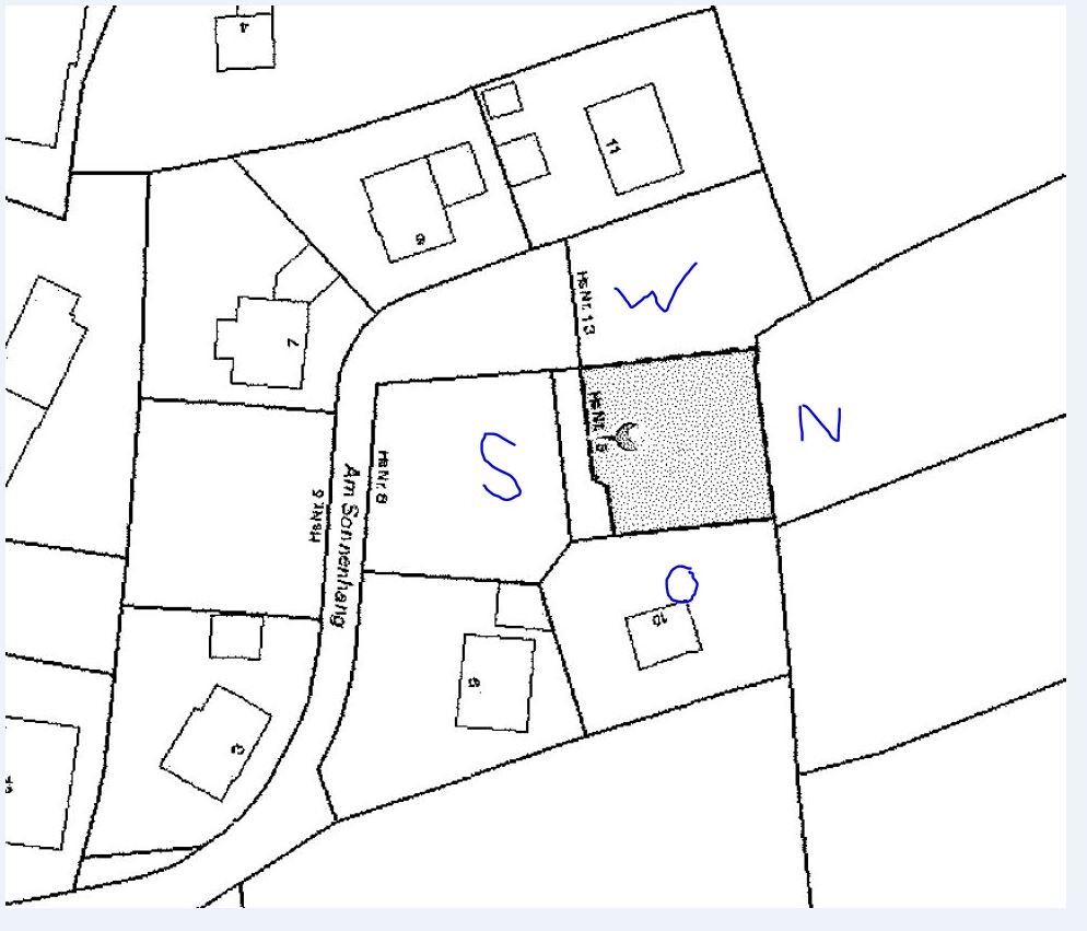

Basically, I would probably rotate the house, with the garden facing west... I have a bit of a problem with the site plan: could you mark the cardinal directions on it?

I’m wondering about the same thing: why does your floor plan have the entrance coming from the south (street side)? Is the access from that direction?
Personally, I prefer to have the garden facing south, like 90% of people do.

I can hardly believe that the building allowance for the garage is only 5m (16 ft 5 in) deep. If that is correct, unfortunately your garage won’t fit.
Bauhamster129 Oct 2018 09:00
Basically, I would probably rotate the house, with the garden facing west... I have a bit of an issue with the site plan: could you please mark the cardinal directions on it?
