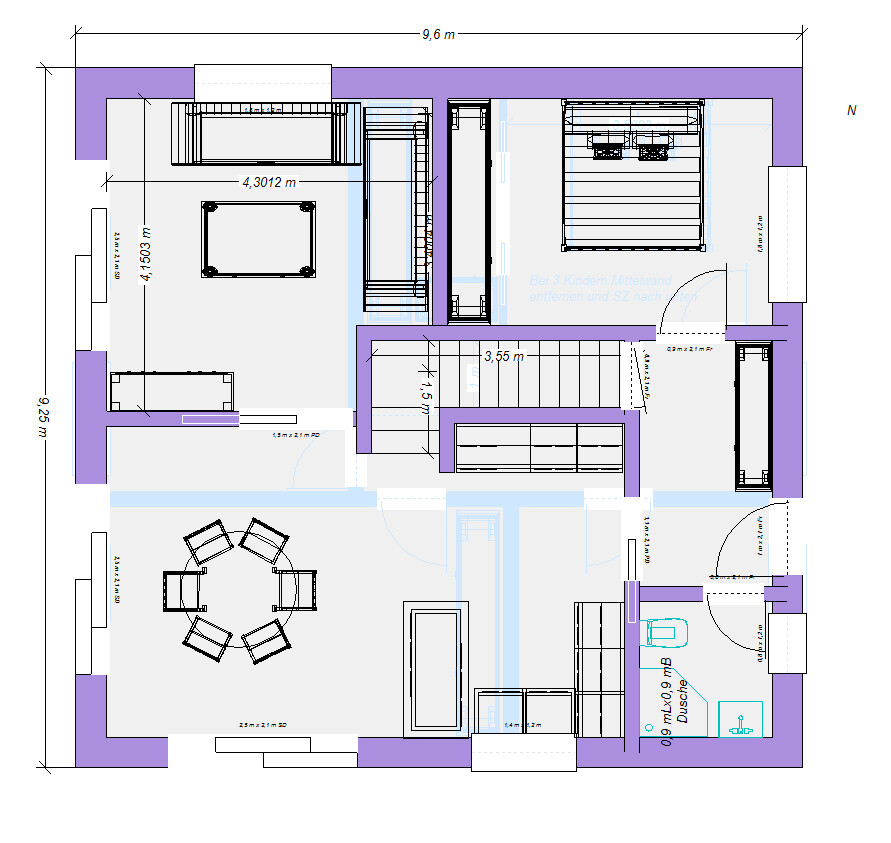

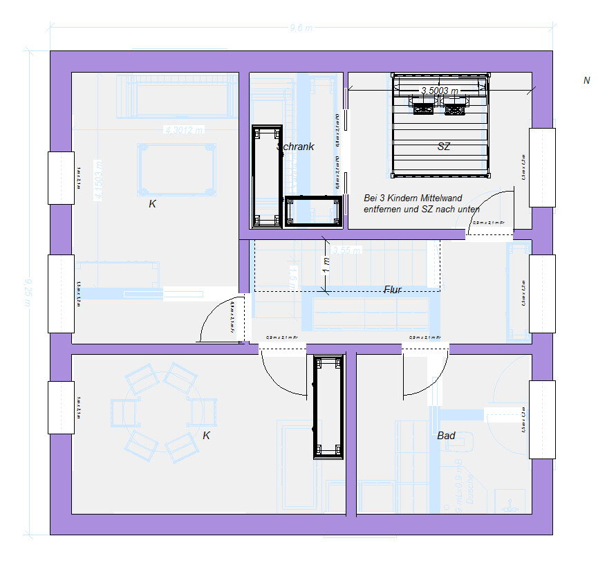

kaho67416 Sep 2019 20:54
2D floor plan of a house with living room, kitchen, bathroom, staircase, and entrance area.
Floor plan of a house with hallway, kitchen (K), bathroom, bedroom (SZ), and living room
This version has 3m² (32ft²) more — otherwise it would have been too tight. The knee wall height should be at least 1.30m (4ft 3in), otherwise the child’s room under the long eaves will be unpleasant. You’ll have to imagine a double casement window in the built-in wardrobe and the child’s room at the bottom of the plan. The chimney only exists if you drive an electric car.
