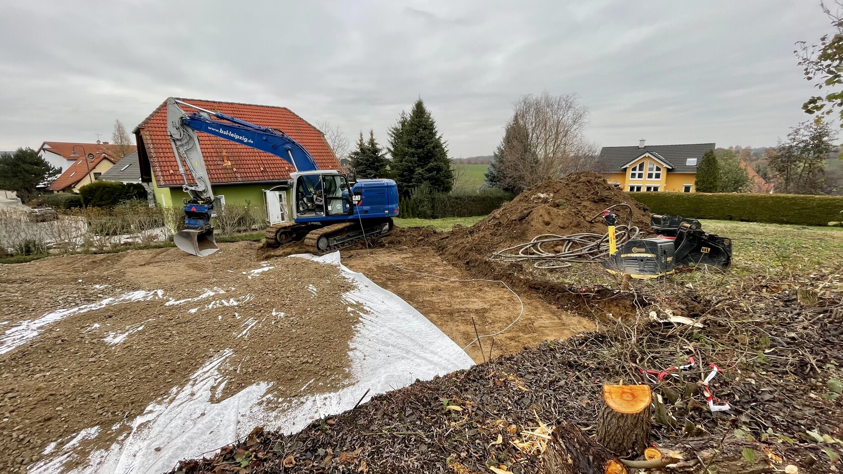

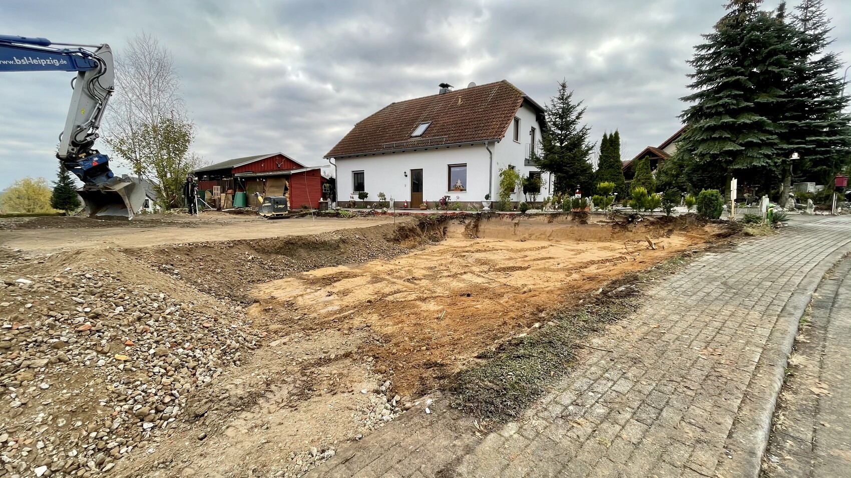

everything is actually very densely compacted. So nothing should happen quickly. However, we will first protect the slopes with coconut fiber erosion control mats. This should prevent any issues for now. At least, I hope so. We don’t really have much expertise ourselves and rely on the statements of the professionals. In the pictures, you can see how it looked at the beginning.

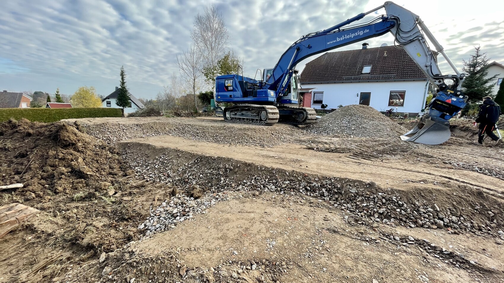

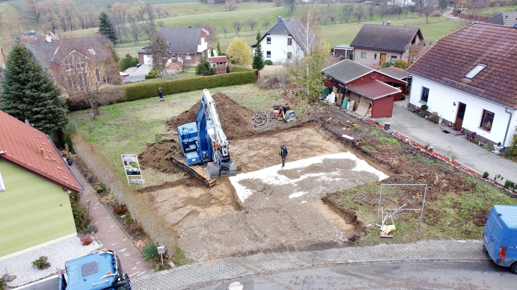

Hello Olli,
We intentionally decided to raise the house a bit to already enjoy the great view from the terrace.
Our foundation slab measures approximately 844cm x 988cm (279 inches x 389 inches). On the left, right, and front sides, an additional 2 meters (6.6 feet) of fill was added, and 4 meters (13 feet) at the back (terrace). At the street side, 30 cm (12 inches) of excavation was done and compacted to create the crane platform.
We had about 160 tons of clay soil removed, 224 cubic meters (7914 cubic feet) of recycled concrete delivered, grounding rings and geotextile fabric incorporated, and the total cost was around 15,500 euros. However, this depends on where you build. We are building in Saxony.
