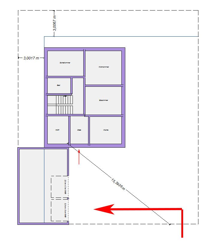

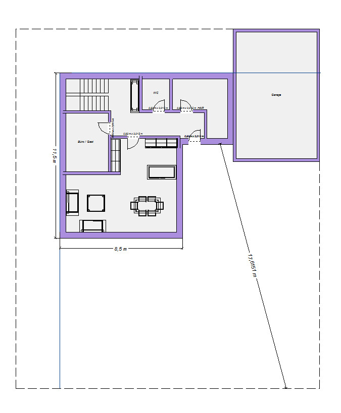

Unfortunately, I cannot upload PDFs. The dimensions are there as well. For orientation: The living room is exactly 4m (13 ft) wide.
Floor plan of a house with kitchen, living room, entrance hall, bathroom, office and guest room including terrace.
Floor plan: two children’s rooms on the left, bedroom on the right, bathroom, hallway, staircase in the middle.
Architectural drawing: north and east elevations and gallery section of a house with a tree.

Sorry, man. But this is one of the worst plots I’ve ever seen here. At least if you need a 9m (30 feet) garage. Setting aside the driveway, have you considered how long your utility lines will be to the laundry room? That’s intense!
The individual kitchen cabinets wouldn’t even concern me right now.
I agree with you, it’s not easy.
Given the current situation here, you can’t really choose. There were 1,200 applications for 24 plots. You should be grateful to get one at all.
We have to make the best of it.
If you have any other ideas, please share. I really appreciate how actively involved you all are.

Have you asked how much the 25m (82 feet) of cables crossing the property are going to cost? Are they already included in the budget?
Have you consciously decided against the south-facing layout with the garage around the corner?

In that case, the cables would be "only" about 15m (49 feet).

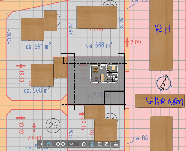

I don’t think the original house position is that bad:
Floor plan of a building complex: central gray building core, surrounding building sections, dimension lines.
Through the northern properties above the garage on the right-hand lot, northwest evening sun can still reach the open yard area during summer.
However, the technical room is worth considering. Is it possible that the utilities might also come from the east, meaning the right side of the plan?
... and clarify whether the ridge really must only run east/west.

Is this something one should maybe consider?
Floor plan of a house: living room with dining table and sofa, kitchen, bathroom, WC, and garage.
This isn’t the same everywhere, but usually, pipes or utilities should not be built over or covered. That would mean you’d have to extend the design quite a bit around the house. Uff!
That’s why I’m trying here to position the connection near the driveway.
