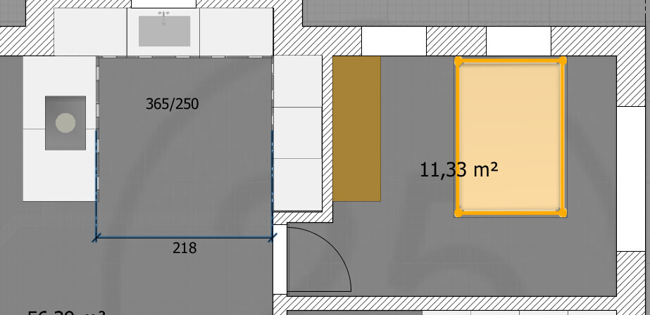

At the moment, we have a 4m (13 feet) long kitchen run on the right side, with 60cm (24 inches) tall cabinets on both sides housing appliances in the middle. The stove and sink together take up about 150cm (59 inches), and we manage fine with this. I think the kitchen is sufficient for our personal needs. Nevertheless, I find the comment valid and have been thinking about it further. What do you think?
Regarding swapping the coat closet and utility room: I initially placed the utility room first. However, that doesn’t work with the window placement. Windows aren’t necessary in the utility room and would just take up valuable wall space. Also, if the guest bathroom window faces east, it becomes harder to fit a shower in there. I also liked the idea of having an open wall right at the entrance to make the area feel more spacious.

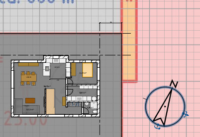

Here is the orientation of the plot again.

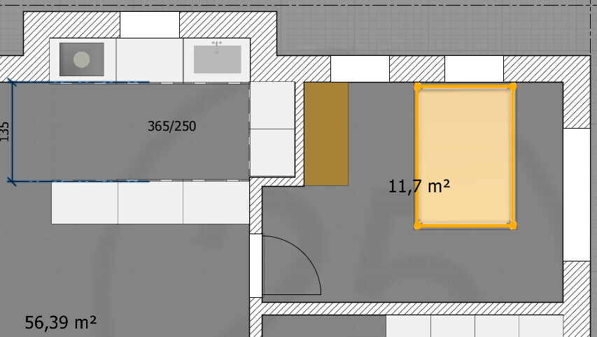

I’m currently working through my messages and notice that the responses to the question are contradictory. So: The kitchen isn’t living up to its potential. More counter space is needed, so a larger island and closer to the main kitchen run, swap the utility room and WC/coat closet,
kbt09 schrieb:
Is the plot precisely aligned to true north? Or could there be some variation, so that north is not exactly at the top of the plan?

Currently, we have a 4m (13 ft) long kitchen run with 60cm (24 in) tall cabinets on both sides. The stove and sink are in the middle, which together take up about 150cm (59 in), and we manage very well with this setup. I think the kitchen meets our personal needs. However, I appreciate the point raised and gave it some more thought. What do you think about this? I’m not sure how it is for you, but over the years people tend to acquire new appliances. In the last five years, I’ve added a blender, a dough mixer, a slow juicer, and a deep fryer. You’ll probably also end up needing to place a few more appliances somewhere. That requires countertop space. It’s better not to settle for just “enough.” The kitchen should be well-designed, especially in the area where you spend or need to spend time every day.
I consider more than 2 meters (6.5 ft) excessive for good workflow, but here it’s not such a problem.
Visually, the island needs to be slightly set back. It should align with the wall line.

I wouldn’t install the tall cabinets. The room on the right can use the space itself. The kitchen benefits from a smaller open area and also gains a small wall for a calendar, pinboard, or chalkboard. Somehow, I’m not comfortable with this opening from the kitchen to the entrance. It feels like you’d always be cooking in the draft, cramped into a corner of the house.
The more I look at it, the less I like the kitchen’s location. Also, the direct access to the guest... There’s a lack of “space.”
I don’t know how it is for you, but over the years you end up acquiring different things. In just 5 years, I’ve accumulated an immersion blender, a dough mixer, a slow juicer, and a deep fryer. You’ll probably experience the same — needing to find space to put all these extra appliances. That means you need enough surface area. Don’t settle for just “enough”; it should be good, especially in areas where you spend or have to spend time every day.
For efficient work, more than 2 meters (over 6.5 feet) feels like too much, but it’s not such a big deal here.
Visually, the island needs to be slightly set back. It should align with the wall line. That probably won’t happen with us regarding machines and appliances. Neither of us are really cooks. We’ve been living in our house with the 4-meter (13 feet) kitchen for 4.5 years, and except for the small capsule coffee machine, nothing else sits out.
Just noticed...
I wouldn’t install the tall cabinets. The room to the right can use the space itself. The kitchen benefits from a smaller work area and also gains a small wall for a calendar, pinboard, or chalkboard. Somehow I’m not comfortable with the kitchen opening directly to the entrance. It feels like you’re always cooking in the draft, squeezed into a corner of the house.
The more I look at it, the less I like the kitchen’s location. Also, the direct access to the guest room... It lacks a sense of “space.” Here is another option. I like it best at the moment.
The refrigerator, oven, etc., would go in the niche, and possibly a bar or open room divider could be added along the bottom run.
The range hood can vent directly outdoors, and you can still look out the window while cooking.
We do often have guests staying over, but 11 square meters (118 square feet) should be sufficient. The main thing is that a 1.40-meter (55 inches) bed fits in.
