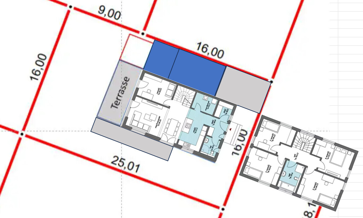

10 Aug 2023 09:28
This could be an example of a house measuring 7.5 m * 12 m (24.6 ft * 39.4 ft).

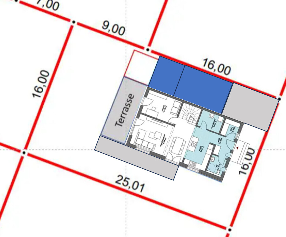

hanghaus2023
10 Aug 2023 10:04
Here is the version including the attic.
Floor plan of a building complex with terrace, interior rooms, and plot markings.
ateliersiegel12 Aug 2023 09:34
If a project — like this one — serves two purposes (garage AND privacy screen), that’s great. However, if this also causes disadvantages (less space), I would build the privacy screen differently. It doesn’t require much space, and there are many options available.

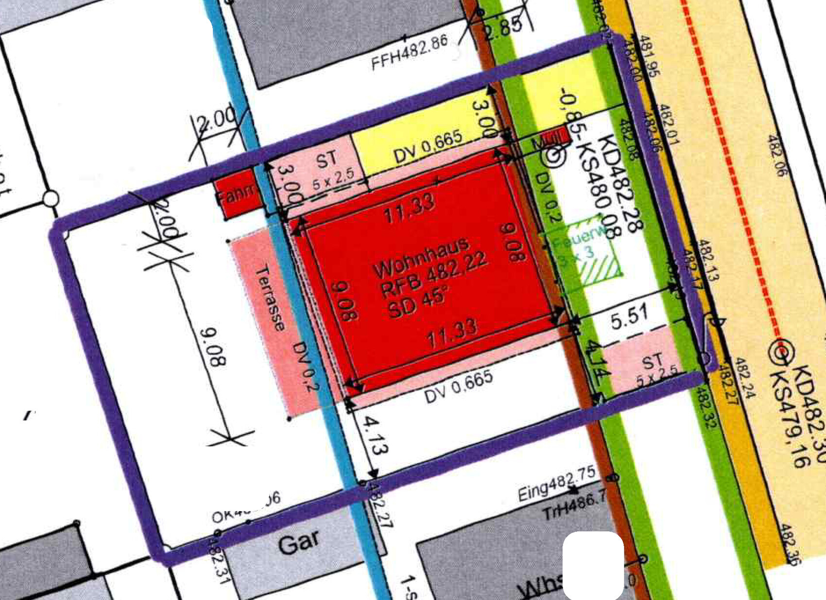

HoisleBauer22
12 Aug 2023 12:17
Here is a similar width / similar issue and how we approached it: Without a garage.
House marked in red on the plan, surrounded by colored property boundaries and dimension lines.
