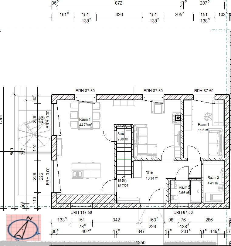

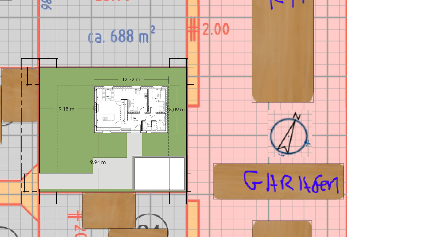

kbt09 schrieb:
I don’t think the original house position is that bad:
Because of the northern neighboring lots and the garage on the right property, there can still be northwest evening sun in the open area of the lot during summer.
However, the utility room shouldn’t be overlooked. Is it possible that the connections might also come from the east, that is, the right side of the plan?
... and clarify whether the ridge really must run only east/west Yes, I think we will keep the orientation as it is.
The utility lines can actually only come from the west. Unfortunately, there is nothing on the eastern boundary.
I will try to finish the upper floor plan today or tomorrow.

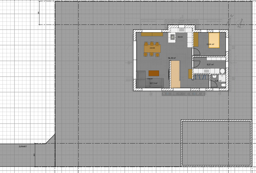

kaho674 schrieb:
Is this something worth considering?
[ATTACH alt="har-Problem.jpg"]38736[/ATTACH]
This isn’t the same everywhere, but normally utility lines must not be built over and shouldn’t be. That would mean you’d have to extend your design quite a bit around the house. Wow!
That’s why I’m trying here to connect it right at the "driveway." Hmm, not a bad idea at all. I’ll have a go at it. THANK YOU!
What software do you use for drawing, by the way?

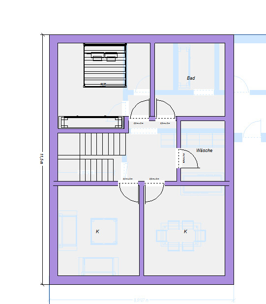

DimaNDS schrieb:

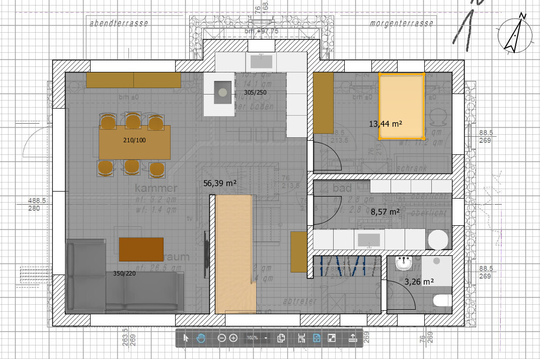

What software do you use for drawing, by the way?Very old program: Architect 3D Maybe better like this?:
I searched through my old plans and found one that might also work.
The fireplace could be omitted here or alternatively installed above, opposite the staircase between the dining and living areas. In that case, it would likely be an external chimney.
It might also be worth considering swapping the kitchen and living areas to open up the window front facing south even more.
Another question is how much the attic space is planned to be used. A straight staircase continuing up there wouldn’t work well. A folding attic ladder would probably have to be used again.

kbt09 schrieb:
I looked through my old plans and found one that might also work.
The fireplace could be omitted here or installed along the top side of the plan opposite the stairs, between the dining and living area. That would be more of an external chimney.
One could also consider swapping the kitchen and living areas to further open up the south-facing window wall.
Another question is how much the attic will be used. Because with a straight staircase continuing there, it won’t work well. A pull-down attic ladder would have to be used again. WOW, thank you very much for your effort!
Even though it doesn’t quite fit our needs. The living room feels too separated—we want to keep the living, dining, and kitchen areas connected since those are the rooms we use most now. Otherwise, we still need an additional room for an office.

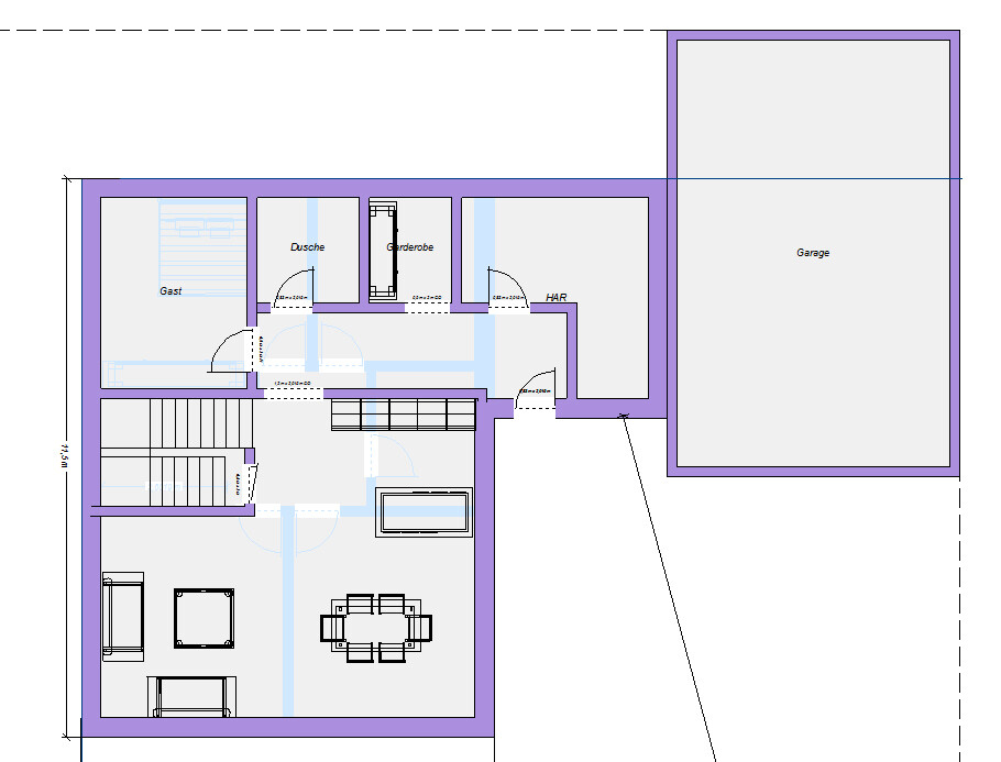

kaho674 schrieb:
Old software: Architect 3D
Maybe this is better?: Thank you for your suggestion. After a lot of back and forth, we concluded that building the utility room is not justified by the cost of the connections. Depending on how much the gas connection will cost, we might forgo it and install a heat pump instead. Otherwise, it’s still electricity, wastewater (which has to be routed around the house anyway because of the rainwater gutters), and fiber optic.
I think we can finalize the house orientation with this in any case.
I will prepare the floor plans shortly and upload them here. Looking forward to your feedback.
Good luck
DimaNDS schrieb:
After a lot of back and forth, we have concluded that building the utility room is not justified by the costs of the utility lines. Depending on the cost of the gas connection, we might skip it and install a heat pump instead. Otherwise, there are still electricity, wastewater (which has to go around the house anyway because of the gutters), and fiber optic lines. This confuses me because I assumed the costs for the utility lines already included water, wastewater, electricity, and fiber optic. I hadn’t even considered gas. I mean, even if the gas pipe can be omitted, the costs for the long utility lines remain. And it’s difficult to proceed without a utility room. Also, what does this have to do with the gutters? What exactly are you trying to tell us?
