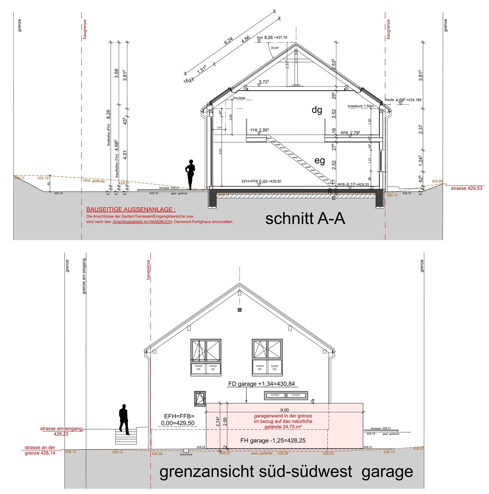

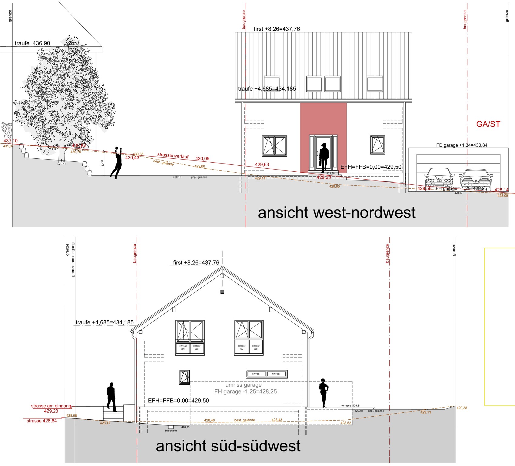

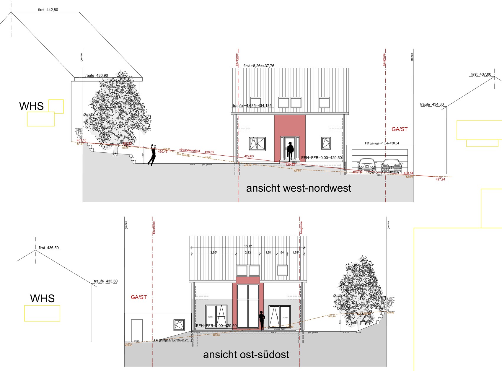

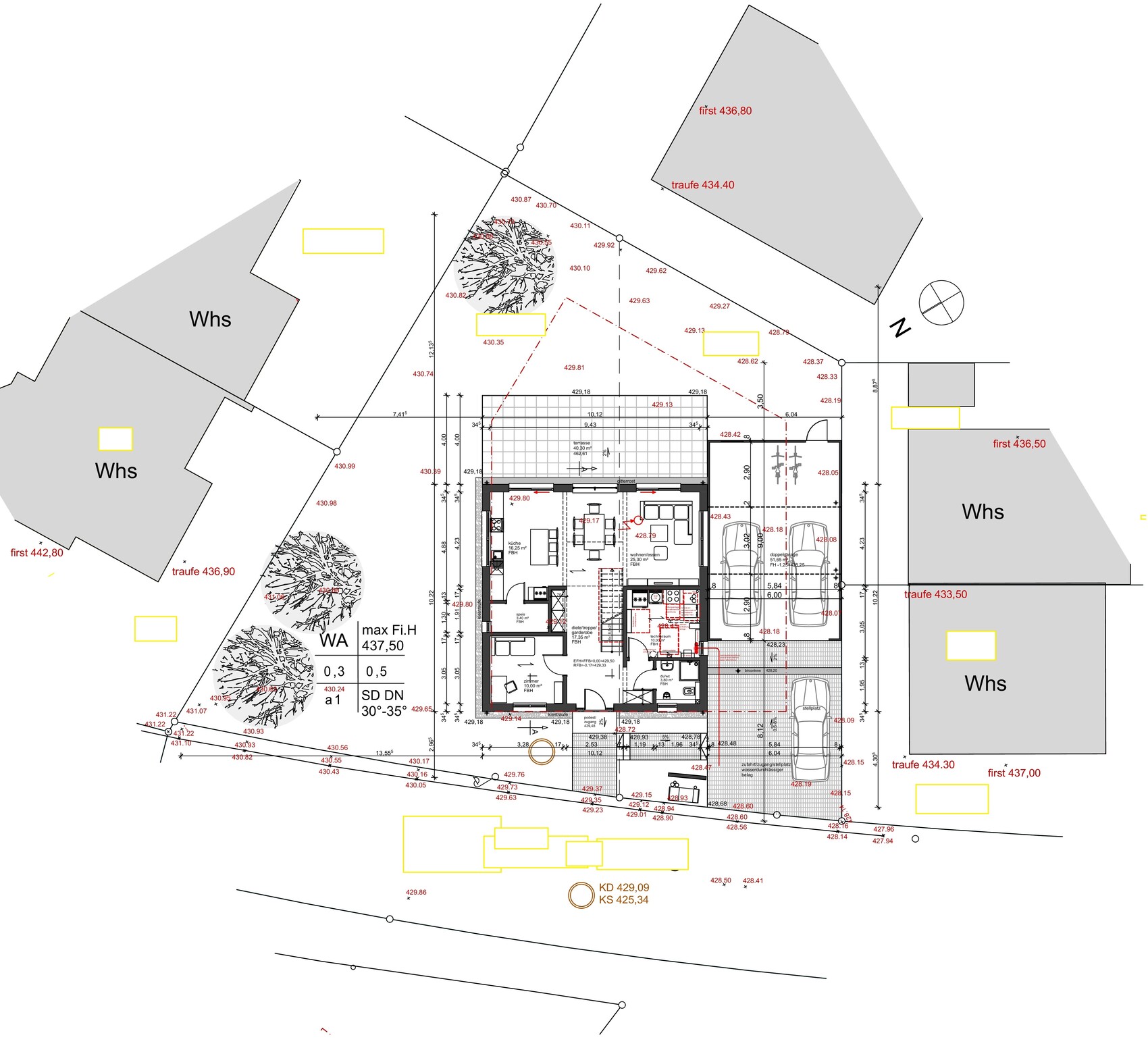

The design is cleverly adapted to the site. You probably have already received some indication from the building authority that construction outside the designated building area has a chance of approval. I consider it—since there is no obvious necessity here—somewhat bold towards those who adhere to the zoning plan. In that case, you simply don’t place a square structure next to the garage.
BenBaut schrieb:
The architect is very confident about receiving a variance for exceeding the building envelope, as well as for surpassing the maximum ridge height. Oh, two variances at once. For her, that is certainly easier than applying more careful planning. A relaxation like that would have been rejected outright, but I suppose it is not even being seriously pursued here (?)
BenBaut schrieb:
Cost EstimateSo what? We want to know if it’s feasible or if we’re just discussing castles in the air.BenBaut schrieb:

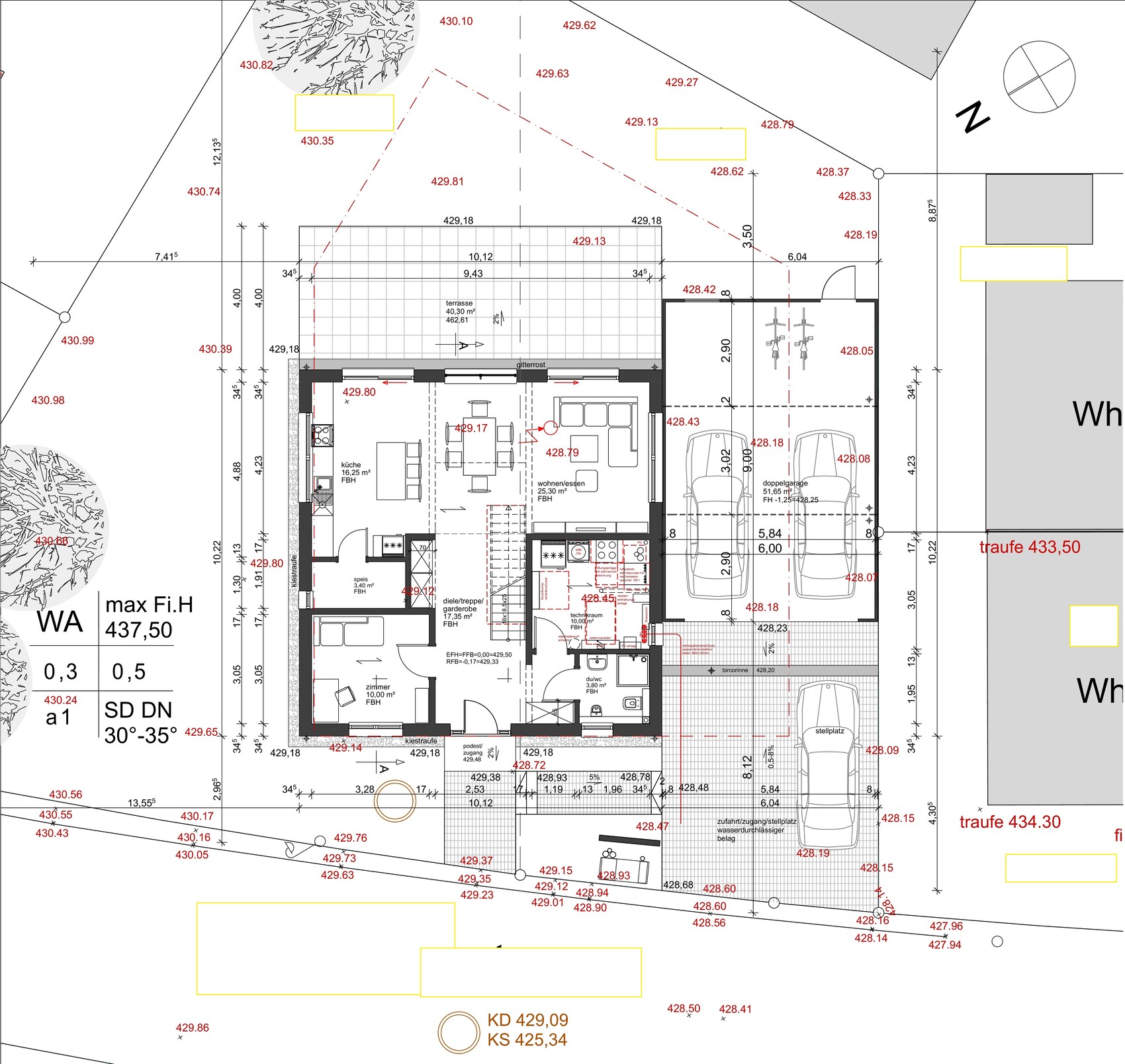

I understand – I didn’t realize that orientation is so important and common practice.
The original plan was like this.Of course, orientation matters. But the north arrow is visible – even on a smartphone 😉I don’t think the design is bad.
If possible, I would place the garage on the northeast side.
Anyway!
The dining area aligned without any separation from the entrance door is either something you like or try to justify. We have the same setup, neighbors do as well, but it also has downsides – privacy...

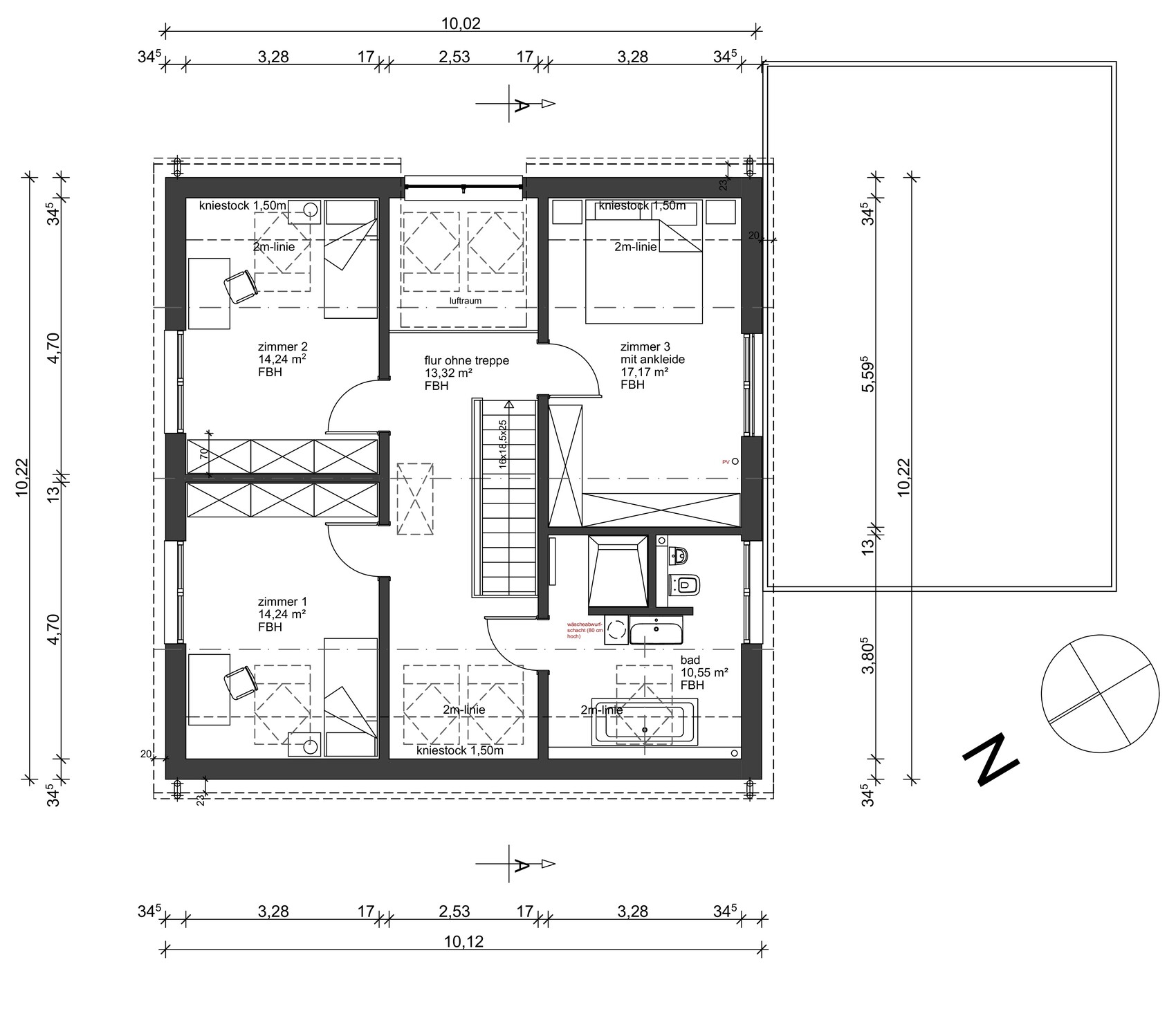

The kids would probably prefer a different layout, so mirror the rooms.
The bathroom isn’t my style; a T-shaped layout always creates corridors rather than usable space. A urinal is out of the question. Replace it with a bidet upstairs. We’re not in a public restroom here...
Wardrobe cabinets are planned. The kitchen looks good to me, but I would consider designing proper tall cabinets for the fridge and oven instead of standalone units.
I would arrange seating more on the side of the island.
The utility room will be too dark.
