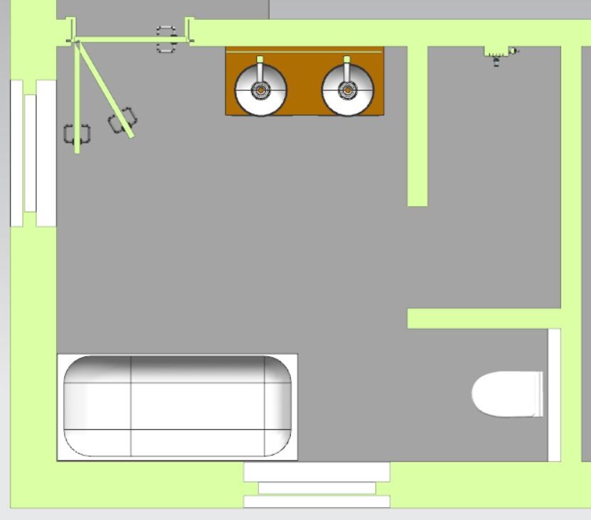

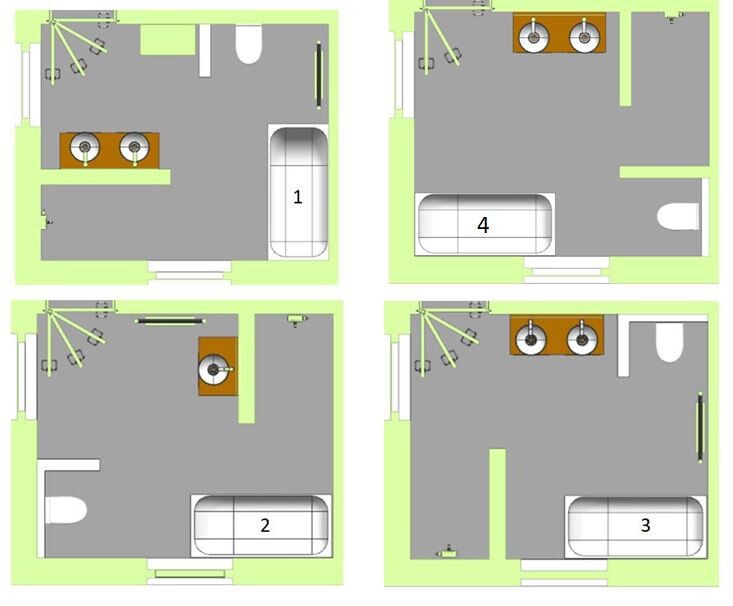

In the bathroom [...] – it’s a winding maze. I think it can be improved.That was my first thought too. I find option 4 a good approach. I would choose a corner bathtub or position it diagonally in the corner. This creates a more natural flow into the toilet area.
I also wouldn’t want to give up a double sink, especially since your bathroom dimensions basically allow it. Maybe it could really fit along the shower wall?
Alessandro13 May 2020 09:11I would also prefer that. Then, where the sink is currently drawn, you could place a towel holder. This way, you can grab the towel immediately when leaving the shower.
