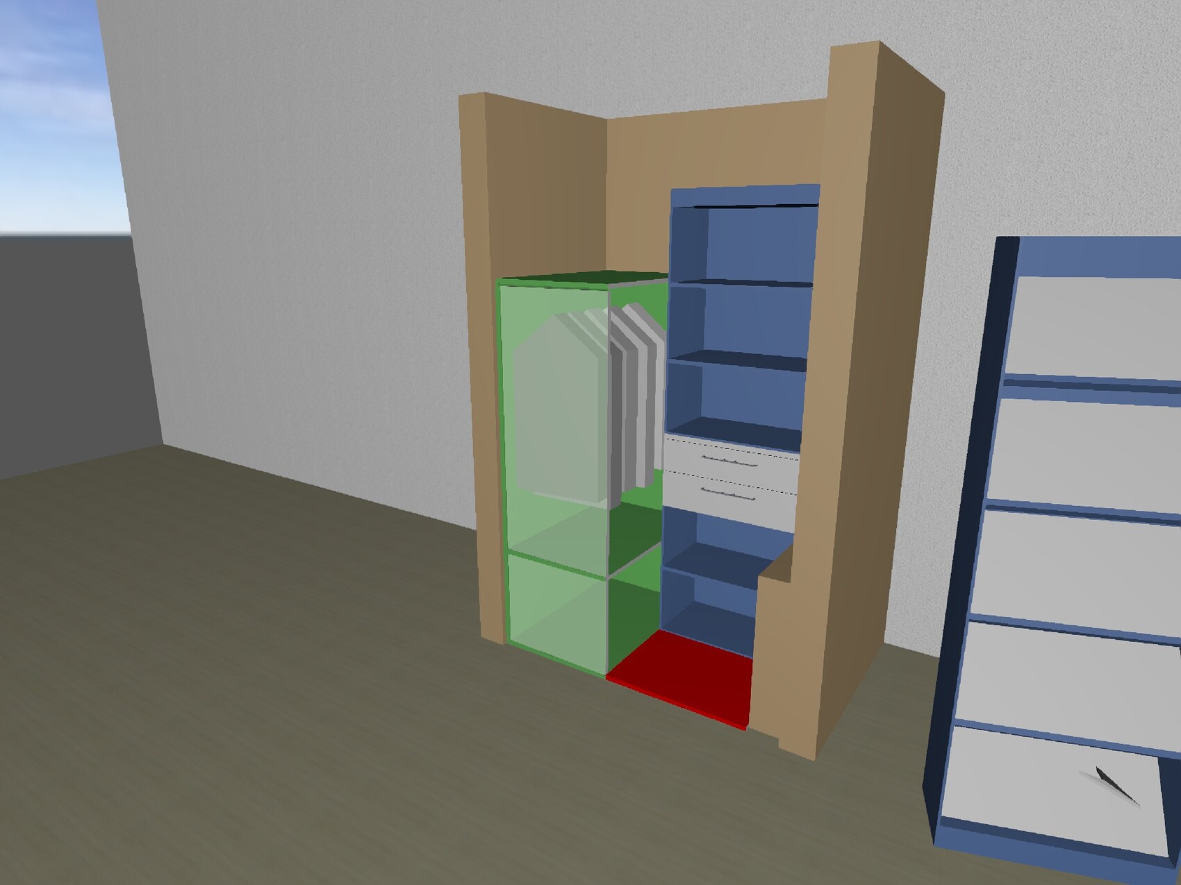

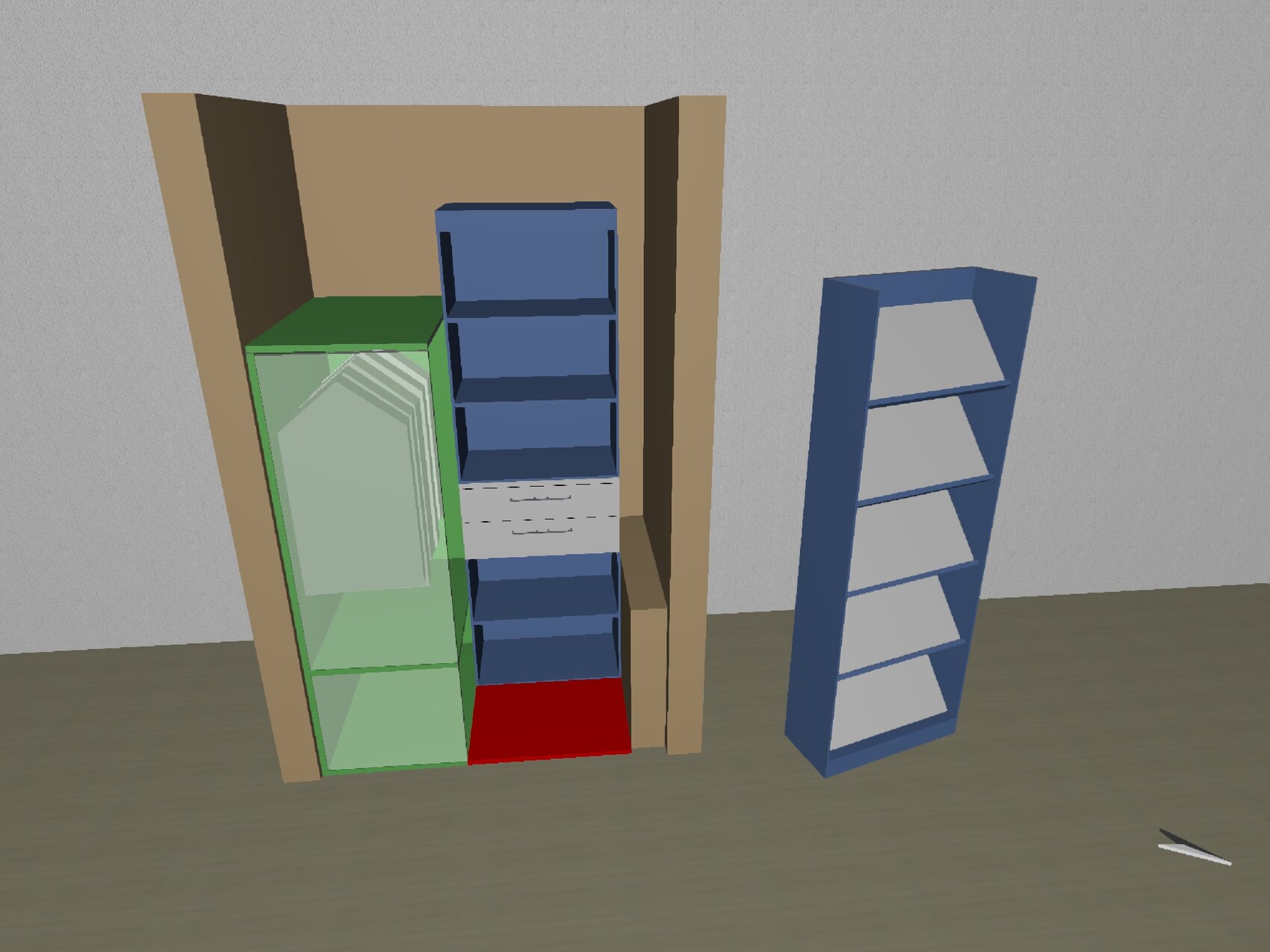

I would plan something like this:
With a room depth of 95cm (37 inches), you only have one option, which is to install shelves with a maximum depth of about 40cm (16 inches) for shoes at the front, and the clothes rail on the left. The other way around, you would have almost no space to move.
I have drawn something up.
Regardless of the dimensions, I would roughly plan as follows:
- A tall cabinet with shelves at the front and an integrated double drawer at a comfortable height.
(Alternatively, a shoe rack, like on the right in the picture)
- The wardrobe on the left.
- On the right, maybe install several hooks for bags, hats, etc.
Alternatively, you could use a proper shoe rack with angled shelves.
The red area at the bottom represents your movement space.
