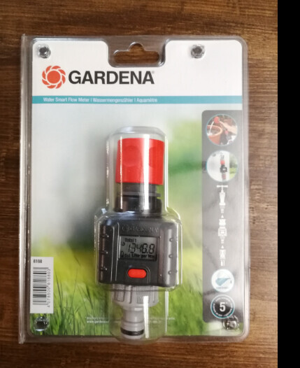

PhiIipp25 Apr 2022 10:28
Gardena water flow meter.
Costs 17 EUR.
GARDENA water flow meter in plastic packaging with display and red top.
Steffi33
25 Apr 2022 11:04
Costs 17 EUR
I think the idea is quite good. That way, we only have one electricity meter at the pump. Since there will be two valves for water extraction anyway, each one gets a water meter, and the division of electricity costs can be determined easily.
