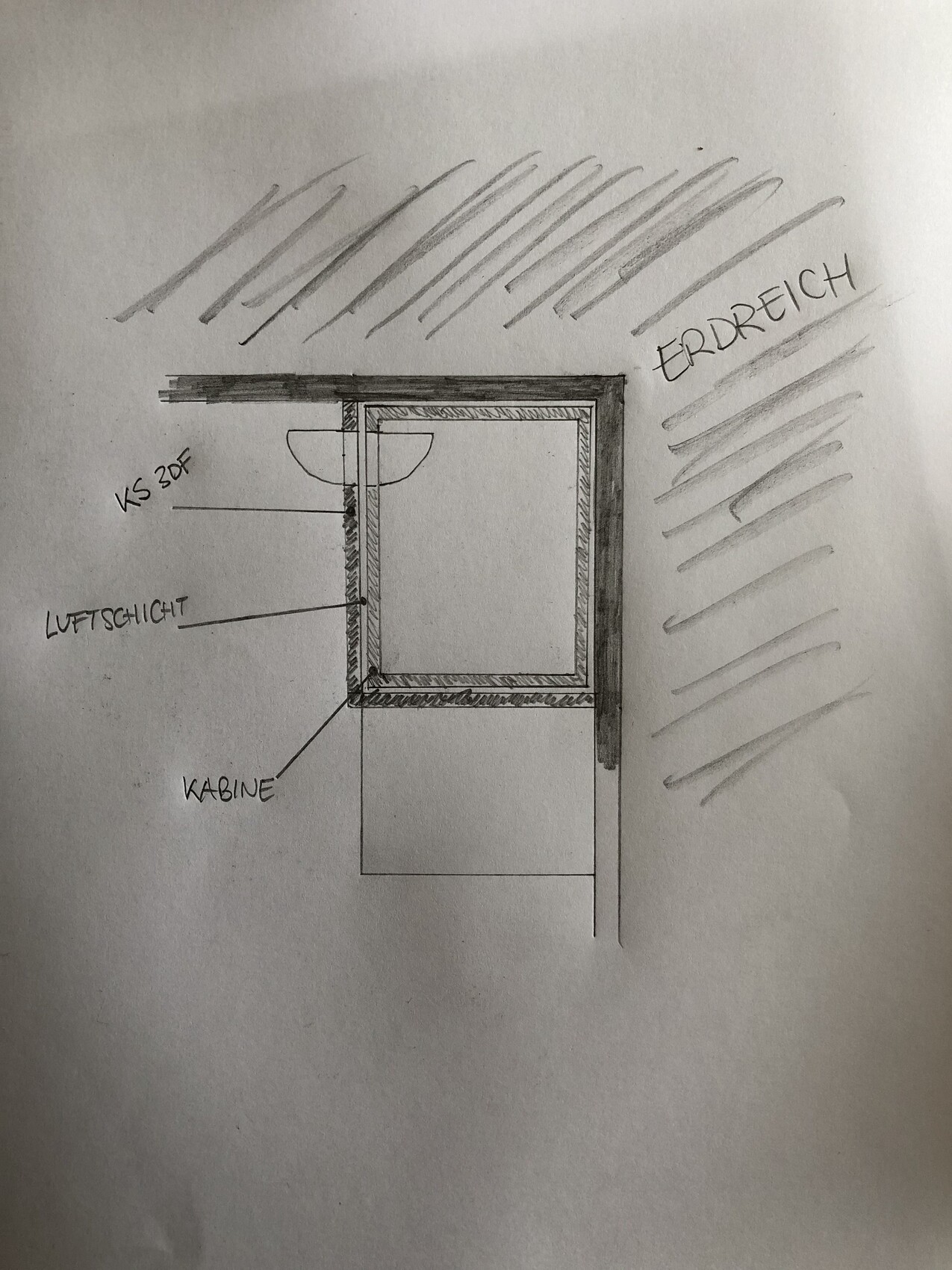

I have an apartment on a slight slope. It has two levels: the ground floor and a basement with garden access. We have just completely stripped the basement. Part of it is a former pool with a floor area of 4x8m (13x26 ft) and it is one meter (3.3 ft) lower than the house’s concrete slab. I divided this area with a calcium silicate brick wall and created a separate room. The exterior walls are underground, so there are no windows. The ceiling height is 3.6m (12 ft). See the sketch attached.
Now I want to build a soundproof cabin inside this room for playing music. It will be a timber frame construction made of 6x12cm (2.5x5 inch) solid structural timber, single-layered on the outside and double-layered on the inside. The ceiling will be built the same way. The walls and floor will be acoustically separated from the screed by Sylomer. There will be an air gap of about 10cm (4 inches) between the exterior walls and the cabin.
