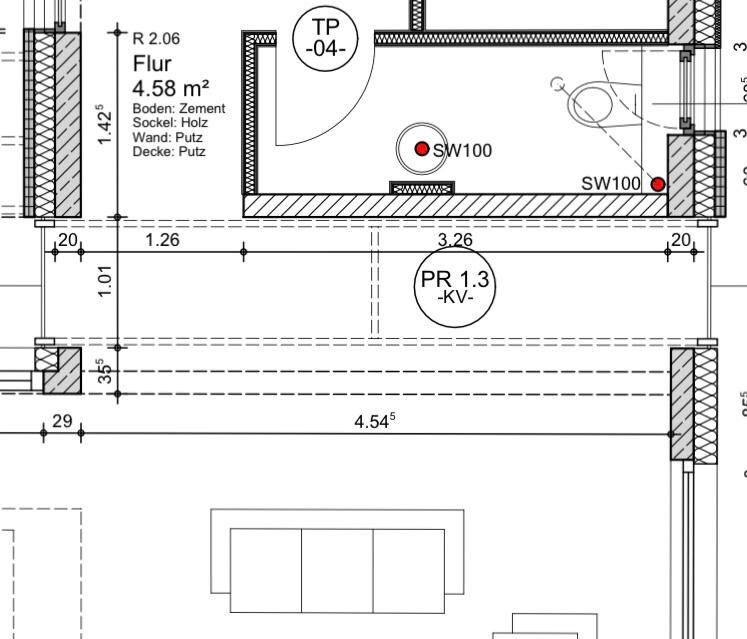

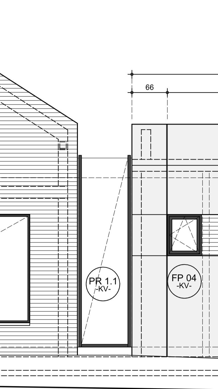

My wife and I are currently building a house consisting of the main building and an extension. The two parts are supposed to be connected by a glass corridor (a three-sided glass element: 2 glass walls plus 1 glass roof).
The window company says they have to build this stylish flat roof glass corridor with a minimum slope of 10 degrees and cannot make it shallower. Their reasoning: warranty requirements.
Unfortunately, we find this very unattractive. We had expected a much flatter roof. Our architect says that a 2-degree slope should be possible.
Now the glass roof in the middle would be about half a meter (20 inches) higher than at the edges, so it would look more like a pitched roof than a flat roof.
Can anyone say if a 2 percent slope is realistic and which manufacturers might offer this?

Schubbiano11 Nov 2020 15:56What exactly are the concerns of the glass installer? (I would worry primarily about the structural load, especially due to the rain weight). What kind of material is planned: laminated glass, acrylic, or something else?
From the drawing, it looks like the top is supposed to be frameless (mitered joint?) to achieve the 90° change in direction. I would suggest using a single-pitch roof instead of a gable roof; the parapet height already allows for the slope, and 10° is hardly noticeable (if necessary, you can design this as a fall, from the main viewing angle).

Regarding your questions: The window manufacturer wants a minimum pitch of 10 degrees. Below that, they will not provide a warranty.
A single-pitch roof is indeed a good alternative. Our architect had also mentioned it before. So now we are hearing about it for the second time...
What kind of glass it will be? Good question. We are assuming standard window glass.
