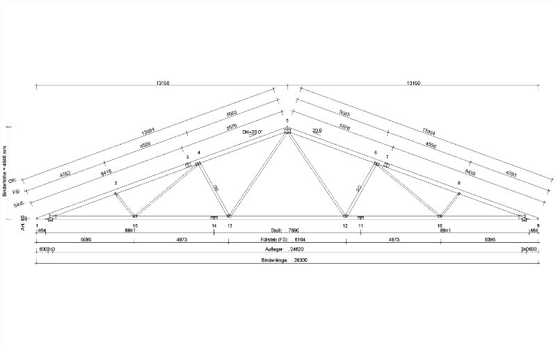

Firstly, 40,000 EUR seems quite high to me for a relatively small roof. Besides that, I don’t see why reroofing shouldn’t provide a long-term solution—at, in my expectation, a significantly lower price. Additionally, a pitched roof would of course completely change the appearance of the house, which is something you need to want in the first place.
A flat roof renovation — even if it ultimately involves converting it into a pitched roof — is, in my opinion, better discussed with the roofer rather than the carpenter. How much the roofer will need to involve a carpenter will become clear during the process. I don’t see a traditional timber roof frame as necessary here; trusses would be more suitable. So neither purlins nor rafters, and also lighter with free-span construction.

Rolexianer11 Feb 2021 16:5811ant schrieb:
A flat roof renovation - even if it ultimately involves converting it into a pitched roof - is, in my opinion, better discussed with a roofer rather than a carpenter. How much the roofer will need to involve a carpenter will become clear as the process goes. I don’t see a traditional rafter roof structure as necessary here; trusses are more suitable. So, neither purlins nor rafters, and also lighter and self-supporting.Good idea, and since trying is better than theorizing, I will contact a roofer!Admittedly, I haven’t fully understood the concept of “trusses” yet, but a roofer will surely know how to work with them.
Are there any typical disadvantages associated with a solution using trusses?
