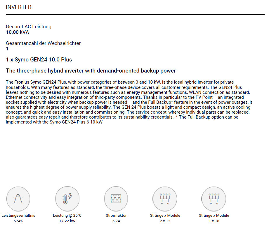

RotorMotor12 Aug 2022 14:25Am I correct in understanding that it is facing north instead of south to avoid overloading the inverter?
E
Elias_dee12 Aug 2022 14:47RotorMotor schrieb:
Am I right in understanding that it fills the north side instead of the south to avoid overloading the inverter?Oh wow, to be honest, I hadn’t noticed that yet. But I think you’re right. I’m going to call him later today anyway, so I’ll ask. An ordinary inverter with 20 kWp would be more optimal, right? It should probably end up costing roughly the same?
So, can more than the offered modules fit on the south side?
Then install as many as possible, and if funds are limited, add the battery storage later (or not at all).
However, in that case, the inverter probably won’t be suitable anymore...

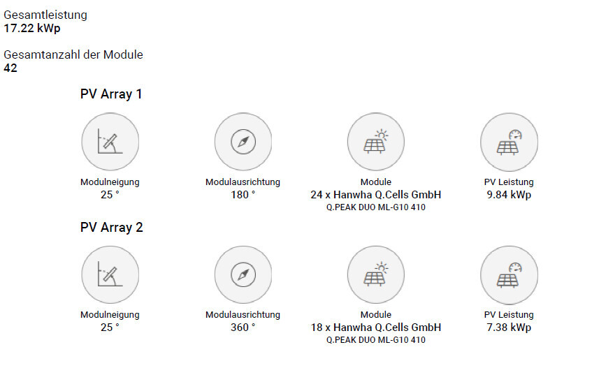

I’ll say it again in case it was forgotten: I’m a layperson, like most of you here, so no guarantees for anything 😉 I just spoke with the solar installer. The report was a mistake – it is definitely the case that the south side is fully equipped (9.84 kWp) and the north side almost fully (7.38 kWp). Not the other way around…
Unfortunately, he can’t supply a “standard” inverter right now…
For clarity, one more question: Is it ever the case that more than 15 kWp actually reach the inverter? If the south side is producing at full capacity (about 10 kWp), the 7 kWp on the north side will most likely not reach 5 kWp, right? Or am I misunderstanding this?
Elias_dee schrieb:
... just to clarify the question once more: is it actually the case that more than 15 kWp ever reach the inverter? If the south-facing side is producing at full capacity (around 10 kWp), then the 7 kWp on the north side most likely won’t reach 5 kWp, right, or am I wrong?At least not at the same time as the south-facing modules...My brother recently installed an almost 10 kWp north/south system on the carport
(for about €800 net per kWp as DIY).
I regularly get the results from this without even asking 🤨
With the inverter, you probably have to accept compromises since the market is empty.
Be happy when something is available and enjoy generating your own electricity. The perfect system
is probably not achievable at the moment.
