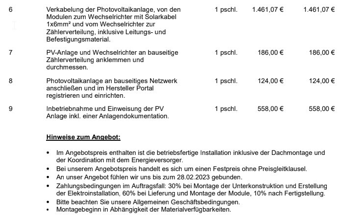

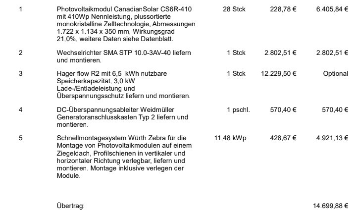

we have received the first offer for our planned photovoltaic system. What do you think about it? Are the materials good and is the price reasonable at the moment? The house is currently under construction.
Roof pitch 35 degrees, east-west orientation.
5 components: PV module, inverter, storage, surge protection, mounting system; total value
Price and performance description for PV system, inverter, and installation.

I would get 2-3 more quotes; I just find this too expensive. Of course, prices have risen and demand is high, but you don’t have to accept everything.
We had the same number of modules, the same inverter, etc., and paid a clean €10,000 net exactly 3 years ago. To give you an idea of the installation: the 28 modules were mounted by a skilled worker and an apprentice on the roof in exactly one day, and the cables were routed to the utility room. On the second day, the master electrician came and completed all wiring and final connections between 8 a.m. and 1 p.m. (including the SMA Home Manager, which isn’t even included in your offer).

I also didn’t see a line item for "scaffolding"... will that be added on top or was it included somewhere else?

The scaffolding depends on the exact timing of the installation and whether we can use the one from the general contractor.
I have also contacted other suppliers, but it takes some time until we receive an offer. Thanks to everyone already for the initial assessment.

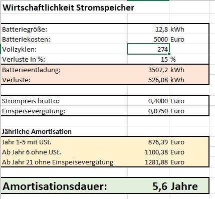

This is how it would look at 5.6 years. For €10,000 (about $10,700), it’s 10.1 years. The indicated cycles are based on my planned system with around 29 kWh. However, the biggest factors are the price and/or the electricity cost.
Table on the economics of electricity storage with battery costs and feed-in tariffs
