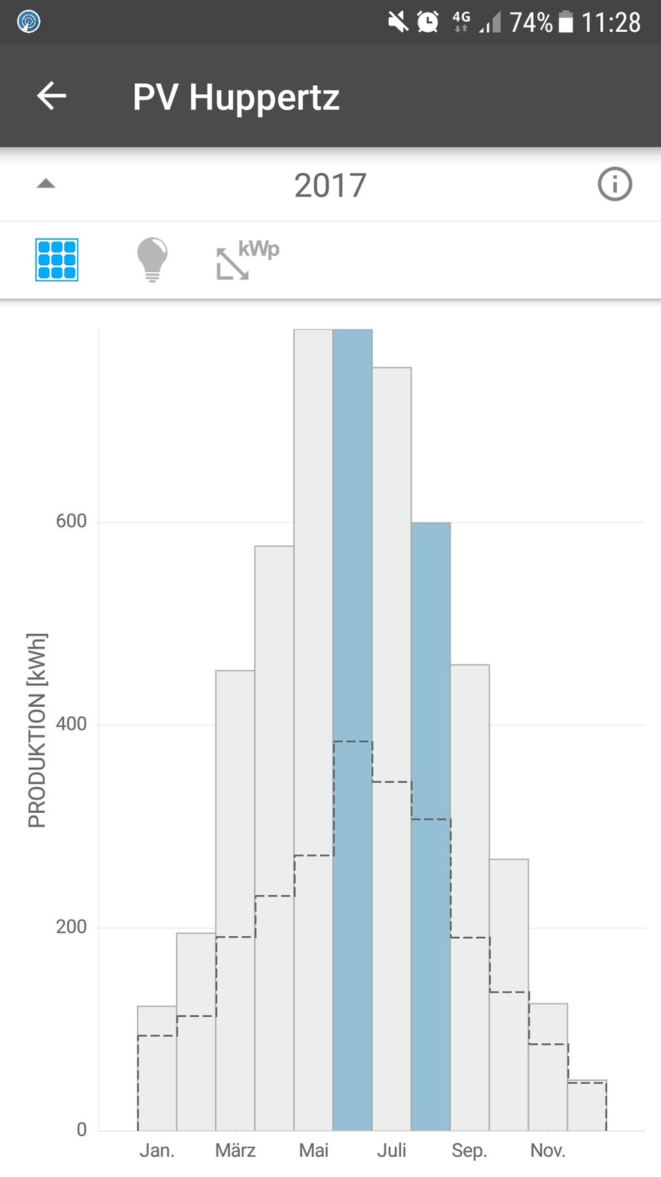

toxicmolotof20 Feb 2018 11:26Because in summer, you simply can’t consume as much electricity as the system produces. That 20% figure is actually somewhat reasonable.
You would need to install air conditioning, a pool, and a pool heater to make a real difference there.
